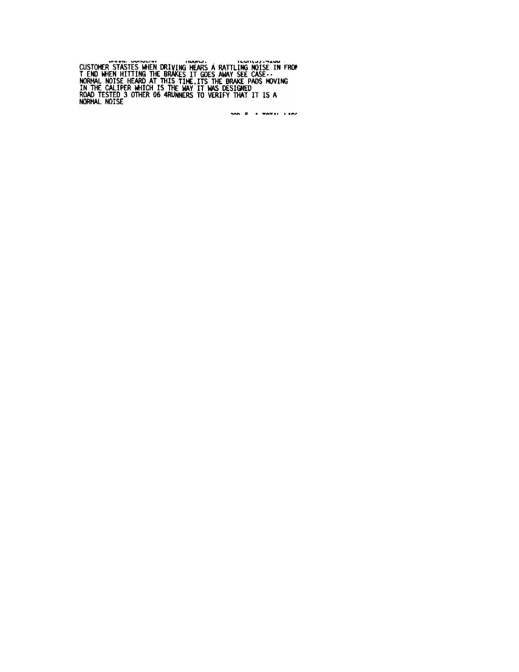

BTW, I hope this does not affect my lemon law case. If it's true that this is NOT normal..which according to many of you it's not..than I should be fine. Check out what the first dealer I took this to had to say aft
er they practially gave up:

Damm, sorry to here that the problem came right back. After hearing that the other shop left out the shims, I was sure that was the problem. With everything being new, maybe it is just a case of too much clearance designed in to allow the pads to free float and not wear when not actually applied. In any case, I wish you luck in your 'lemon law' pursuit.
Well, the lawyer said if they began to attempt to fix the problem, that in itself is them admitting it IS a problem and not a known defect.
