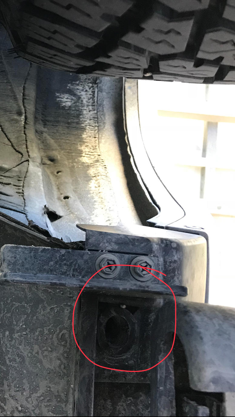

Is this hole where the drain line comes from? Removed the door sills and saw the line. The dealer also blew out the ac/sunroof drain. After removing the sills covers and feeling around underneath the carpet the foam was not wet and the floor of the vehicle was dry. Also, I did not see any drain holes. What am I missing?
