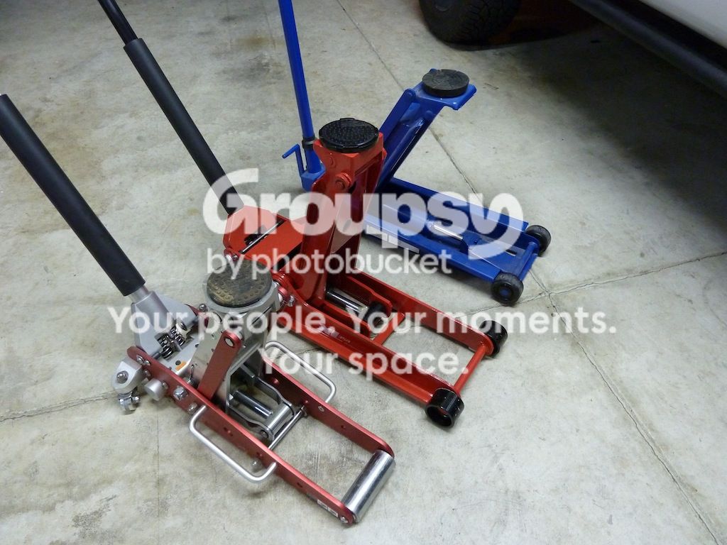

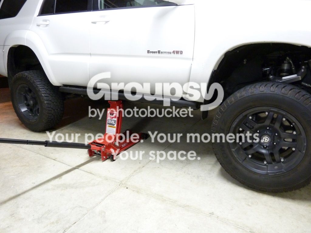

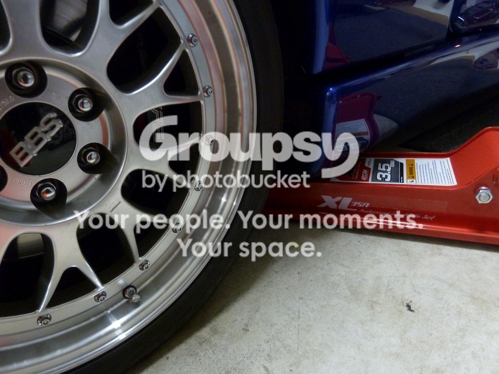

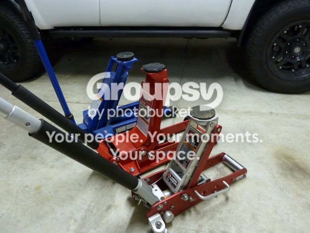

The Arcan XL35R jacks from Costco are by far the best floor jack out there for the money. I got 2 of them a couple years ago just because the price was so good. The lift range is low enough to get under the Viper and max height is high enough (21 3/8") for the 4Runner. The double pistons also make for fast lifting. IMO stay away from the light weight aluminum race jacks for your 4Runner. I also have a couple of Torin Aluminum Race Jacks which are fine for sport/compact cars but they feel like they'll gonna crumble under the weight of a 4Runner. They're light weight and are made to take to the track and service race cars. For the garage, stick with steel jacks.

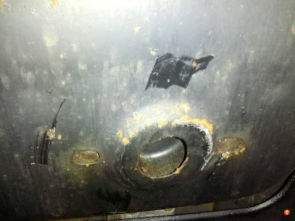

I just jacked the front of the 4runner for the first time and I think I jacked it up on a wrong place. I jacked it up at this round bump. I also bent one side of the round bump. Is this the wrong place if so where is the correct place relative to this bump. Thanks in advance.
It looks like you jacked up on the skid plate. You definitely do not want to do that with the stock skids. Use the frame rail or crossmembers. When in doubt reference the owner's manual. Good luck!
Thanks for your reply. I read somewhere on this forum that it was OK to jack on the skid plate. Guess it was 3rd gen and doesn't work with 4th gen. Next time when I jack the car I will definently use the cross member for the front. Also I was unable to find jack points in the manual. Thanks again for your help.
No problem! There very well could be an ok spot on the skids to jack from. But they're such thin metal I wouldn't trust it. One other decent lift point I've used is the front lower control arms. Good to use for various different circumstances ie. Only working on the front left wheel..
Just found the thread that mentioned that jack point it was in 4th gen not 3rd gen . Alot of people had success with it guess I did not align it properly. I will use the frame rails in the future.

Congratulations on using that spot as a lift point. Seriously.
You now have no reason not to take advantage of such an utterly convenient lift point in the future. The "damage" is done.
Btw, the spot is very strong. There's a beefy piece that bridges the gap between the skid plate and front cross member.
i used a jack on that spot before with no problem. i put a 2x4 between it and my shop jack and had no problems. i did put it on stands right after to prevent damage as i would not feel save keeping it on the front skid
