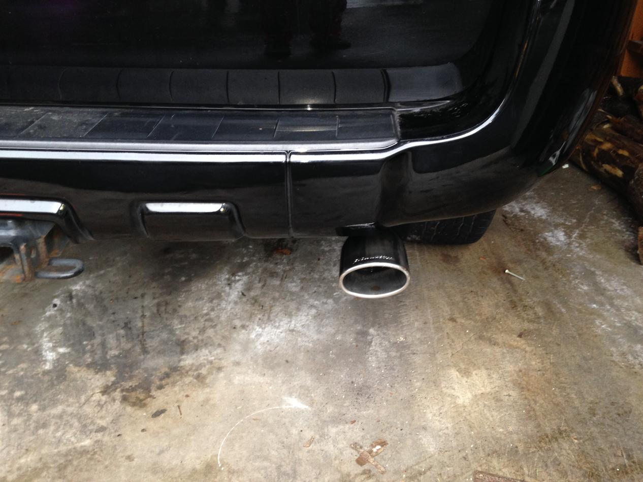

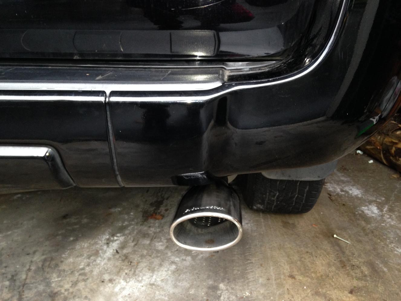

Post up some pics when you get a second I'd really like to see it.
Sure thing :)
