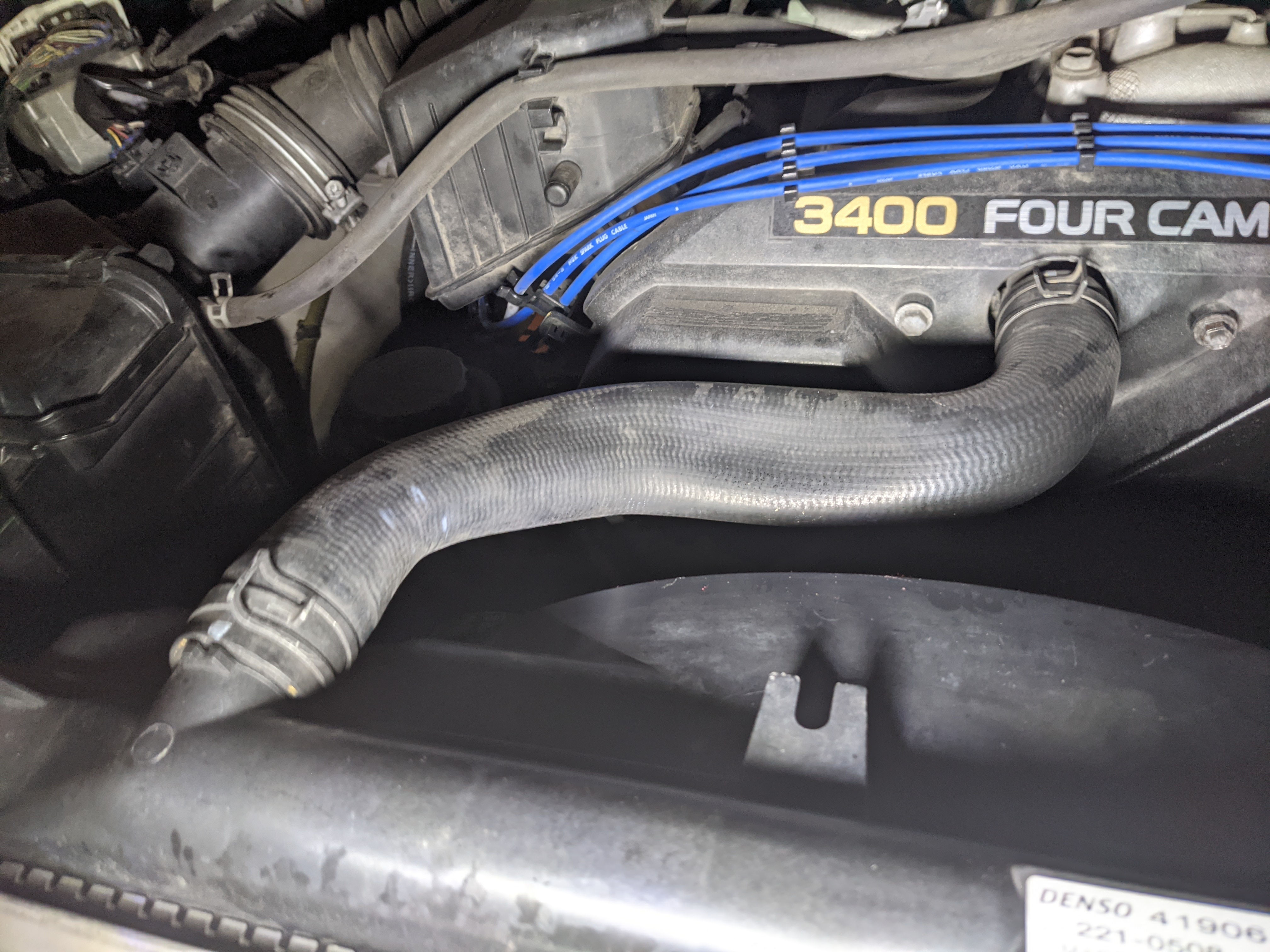

I have a fluid leak and suspect it's coolant as the reservoir is low. From looking under the engine bay, this hose/cap looks to be saturated - anyone know what it might be?
Thanks in advance.
That looks like the vent line for your front differential if you have 4wd.

As others have said, that oily hose is the front diff breather. It can sometimes burp a bit of gear oil after high speed 4WD operation. It is worth checking the front diff fluid level, but everything is probably just fine with that.

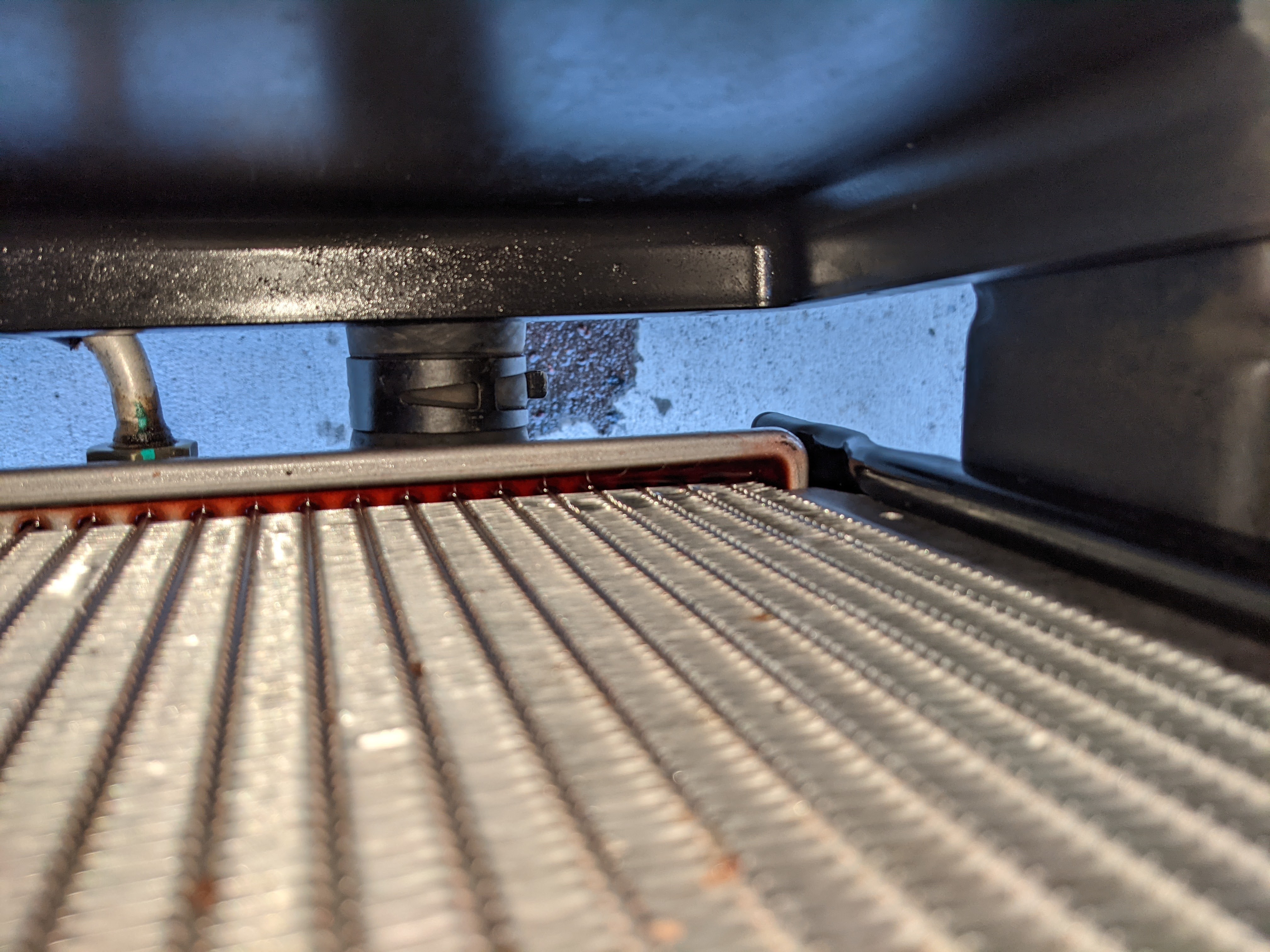

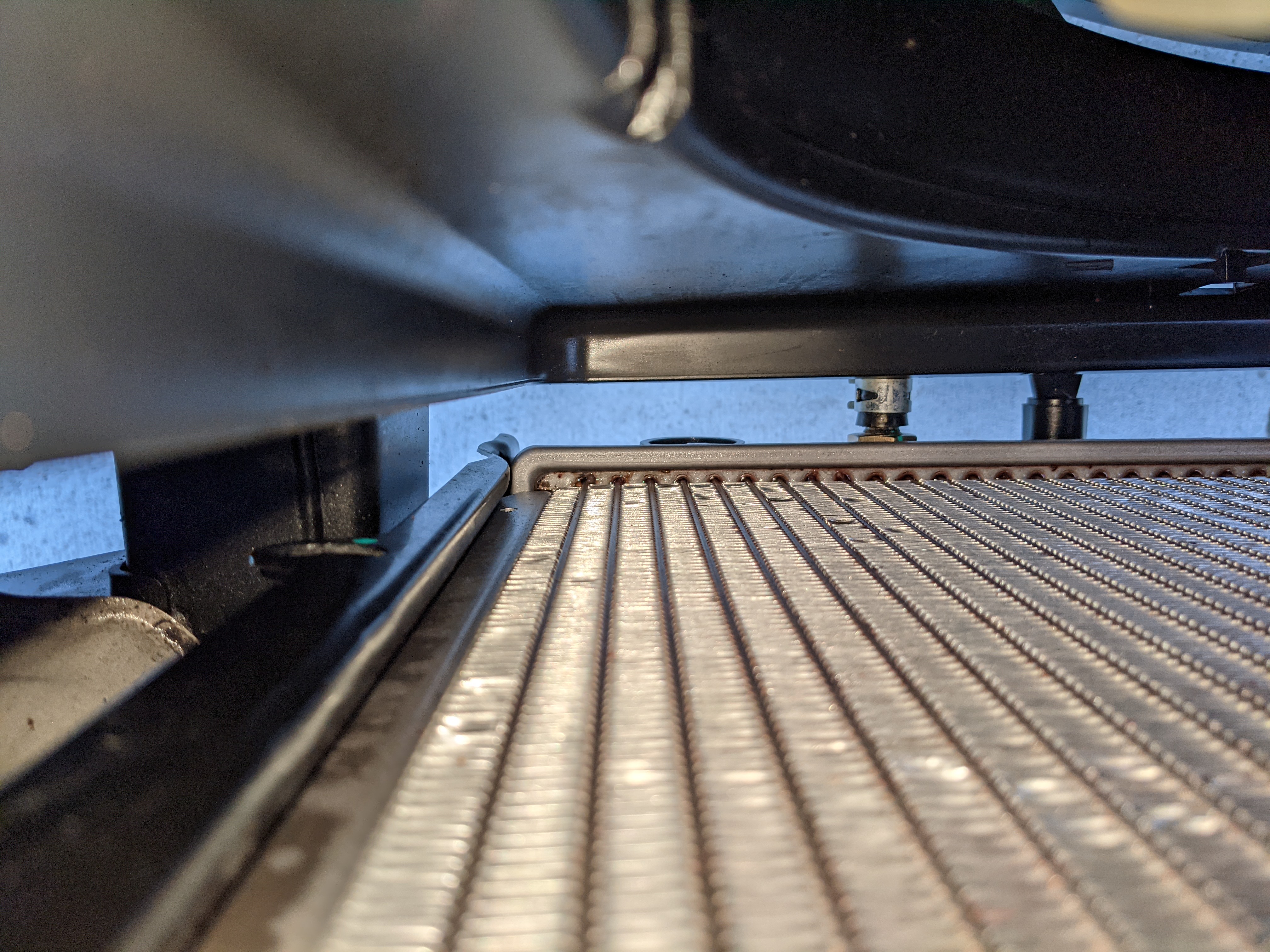

Edit: I had the shop that performed the radiator replacement give it a onceover this afternoon and they're sure the fluid is ATF, not coolant.. they weren't able to identify the source of the leak and suggested hitting the front end with a proper pressure wash. It's also possible there's still fluid in the aftermarket cooler which I capped the ends of but didn't unmount - I'll probably remove it and figure out how to remount it later if it turns out to be undamaged.
Resurfacing this thread as I'm afraid this is still not resolved
What I've done:
  • Replaced radiator cap with OEM
  • Removed tranny cooler and reconnected hoses
  • Had tranny cooler pressure tested at a transmission shop - fully checked out, no leaks
I wiped everything down until there wasn't a drop of fluid anywhere, then waited a few days. Once again, there was a small puddle of fluid under the truck.
Tranny fluid seems to be pooling up at the base of the radiator where the stock cooler sits. I don't think the radiator is punctured since it's not coolant. There's no wetness anywhere above this spot nor along any hoses/clamps. The photos make it seem like it's pooling on the driver side but this is because of the driveway grading; I was previously parked in a different spot and it pooled on the other side.
Driver side (between fan shroud and radiator)
Passenger side
Is it fair to say the stock cooler is faulty? As I mentioned above, the radiator (OEM) is just over a year old and was installed by a trusted shop.

I doubt it's the transmission cooler in the radiator. The stock transmission cooler is surrounded by coolant except for the two fittings on the bottom that are external to the radiator. If the transmission cooler were leaking you would have a strawberry milkshake going on in your transmission. Are you sure it's transmission fluid and not coolant?

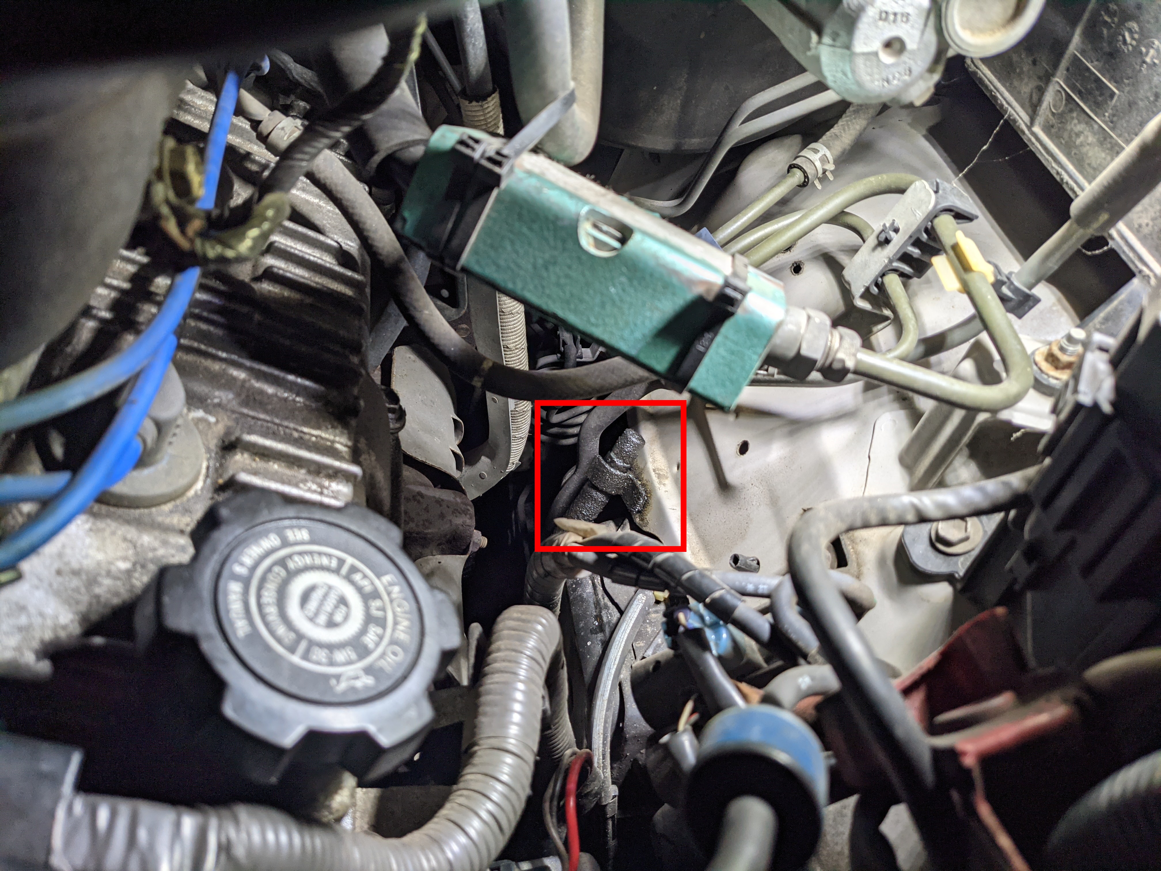

I sprayed the undercarriage with Simple Green yesterday and pressure washed everything from the bottom, which I'm hoping helps to see where any leaks may be. I also read a few threads on the low and high pressure PS lines developing leaks/cracks, so that's what I'm hoping to identify when I take a look later today.

  • Thanks to RumHam26 for suggesting to check the PS reservoir since it also uses ATF - sure enough, the level was quite low and I topped it off before mentioning it to the mechanic. He found a small leak coming from the PS return line and fixed it by replacing an 8" section of the hose.
