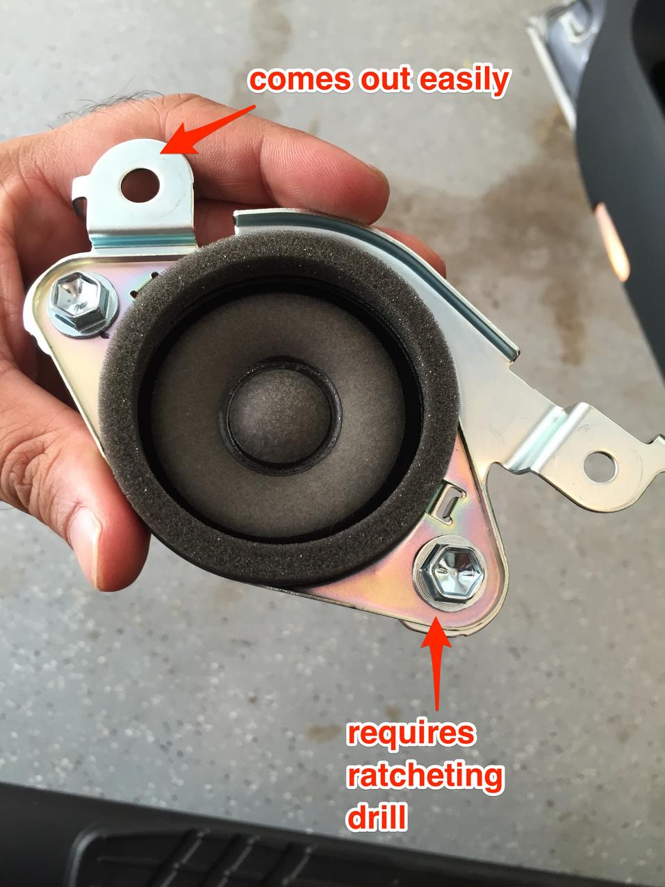

I mostly followed the instructions on the master sheet from Crutchfield. Did the tweets first. They worked exactly as described, but with a couple of gotchas.
  1. They are pretty strong magnets, and they like to attract metal parts, which will tear them.
  2. You'll need a ratcheting drill, and a vise, to get the brackets from Toyota to separate and make room for your Focal bracket (see pic attached below)

Ha-you're totally right; I remembered I needed to take pics about halfway through. I attached a pic of the one weird thing I did find.

Ratcheting drill? What's that?
I put the nut in my vise and turned out the bolt with a regular ratchet
