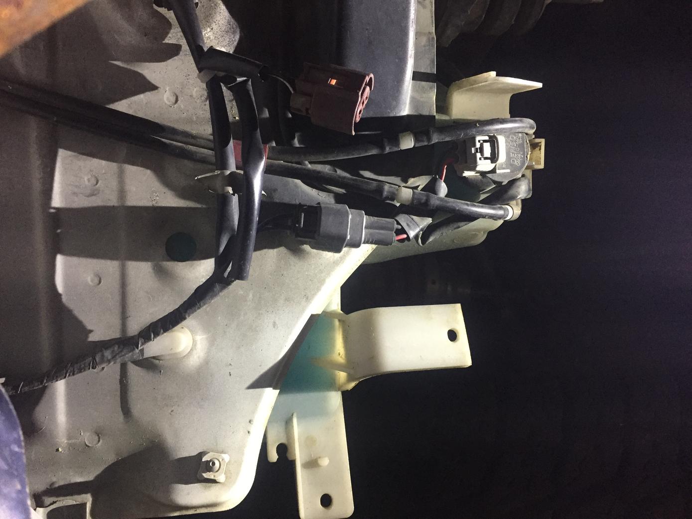

yeah, it gets tied into the set of wires that also go to the washer fluid pumps if you pop the hood and look at where the washer fluid hoses run into the engine bay you will see a loom of wires and and about 6" after it goes under the head light the fog light circuit splits from the loom and has about a 6-8" of wire before the connector
