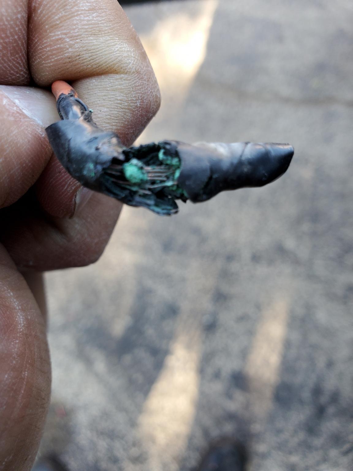

Found the culprit. I didn't get any continuity between A40 pin 5 to the relay/driver side junction box assembly at connector 2D pin 9. So, I started checking the wire and saw that it had been spliced into. When I looked at it more closely, I saw a ton of corrosion all over the wire (pictured below).
Here is why it was spliced into:
When I first bought the truck used. The previous owner did the DRL Fog Light Mod. I hated it and reversed it because I wanted to be able to turn them on and off at will. Apparently, moisture got into it somehow and corroded the crap out of it. I cut out the corroded part of the wire, installed a new wire, and now the fog lights work perfectly.

Good job, you found the problem and repaired the corroded connection. You had a good start getting the wiring diagrams and figuring out some of the pertinent circuitry.
