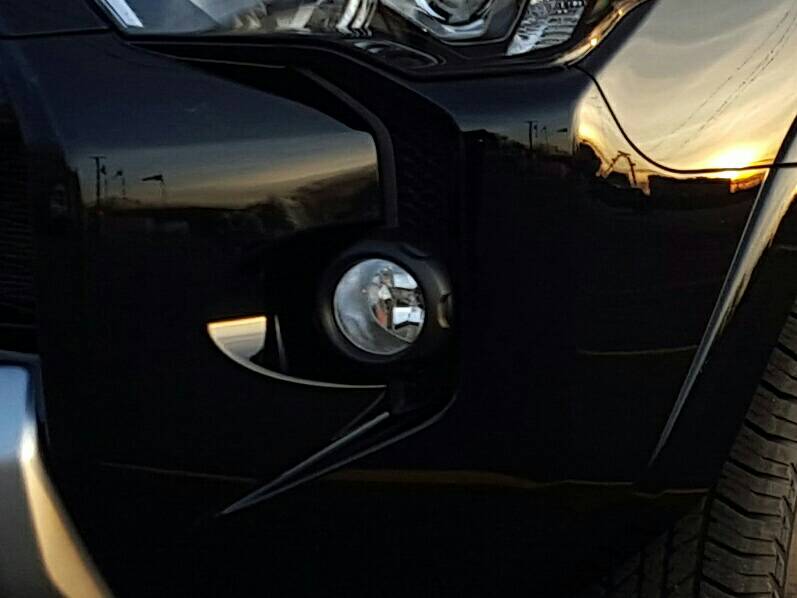

I am assuming the fog light trim just pops out? Has anyone removed it and has a technique for doing it properly? I don't want to break any clips...
There is one snap clip towards the top that you have to pull out from behind the bumper. After you take that out, you can carefully pull the trim piece off from the front. I have pictures from when i did it, but i think they're on the iPad.
