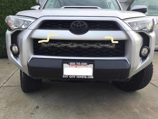

You think you could snap a picture or two of the brackets? Did you use existing holes or drill new ones? Did you have to trim any of the plastic air dam material?
I was messing around with mounting ideas today, and this seems to be the best option for a bar this size, unless I make some serious bracket/mounting setup.
No trimming of the plastic air dam was needed, it's a tight fit but didn't have to cut. I made the brackets to line up with some existing holes that were not being used by anything. Here is a artistic rendition of what the brackets were like because I didn't take any pictures of them. The OPT7 brackets attach to the bracket I made. I also took a thin piece of metal to mount the bar to a plastic clip that holds the air dam in place (one side is on the bolt that holds the bar to the bracket and the other held down by the plastic clip) to keep it from wiggling forward and backwards. It's in there super solid now.

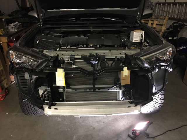

This is a picture of the bar it is mounted to and how I got the measurements, just taped that cardboard there put the bumper back on and drew lines where I wanted the top of the light bar to be through the venting in the bumper.

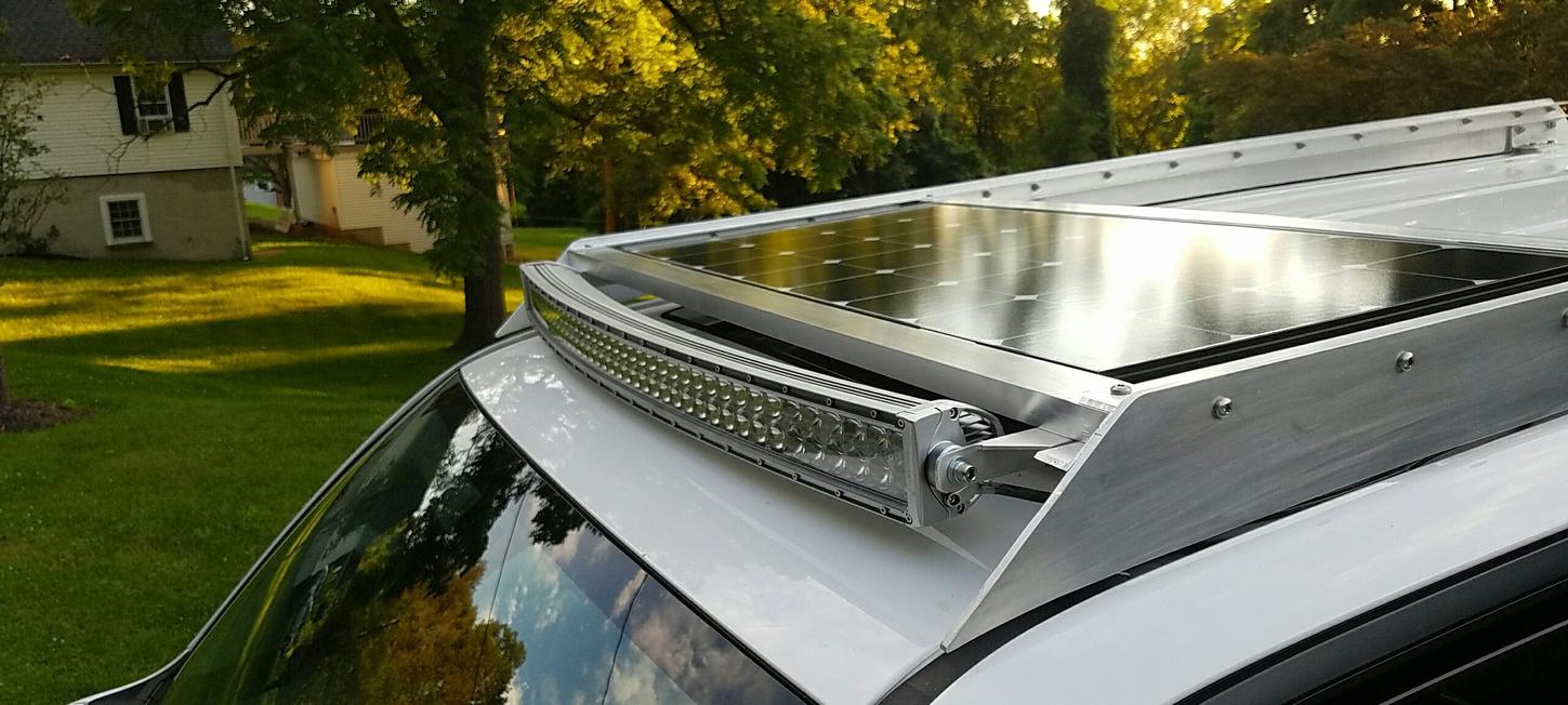

Question for everyone here with Gobi rack and LED bars. Are you running 40" bars or 42" bars? I am thinking of putting a 40" curved but there seem to be less options on amazon compared to 42". Would the 42" look "awkward" with the stealth racks?
42" El cheapo Amazon

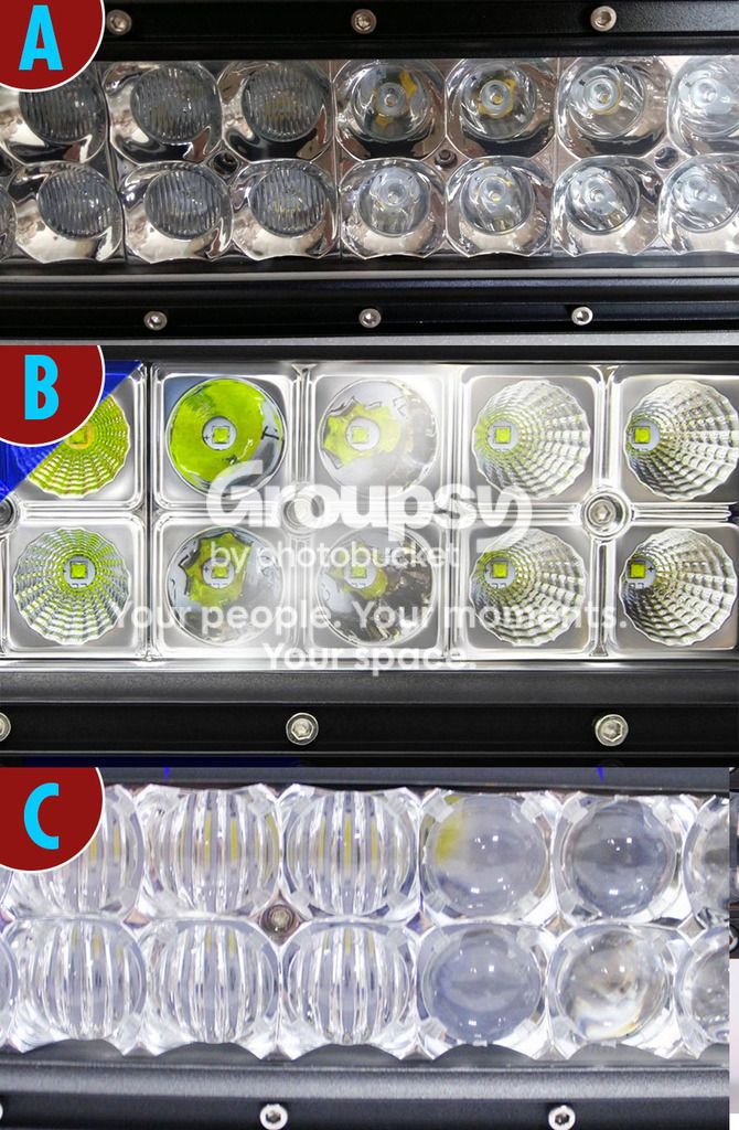

...One thing to remember is an LED is an LED. They do have different powers and quality grades but the "patent" on most LEDs has to do with the reflector design. Obviously there is more to it but that my cliff notes version.
So in your opinion what is the reflector design that is the best out of these 3?
