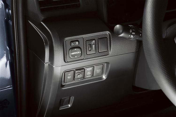

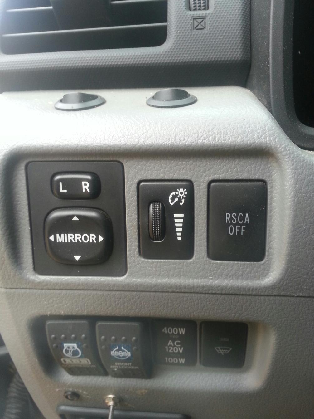

See attached image: Factory Switch Location and My Moved Location

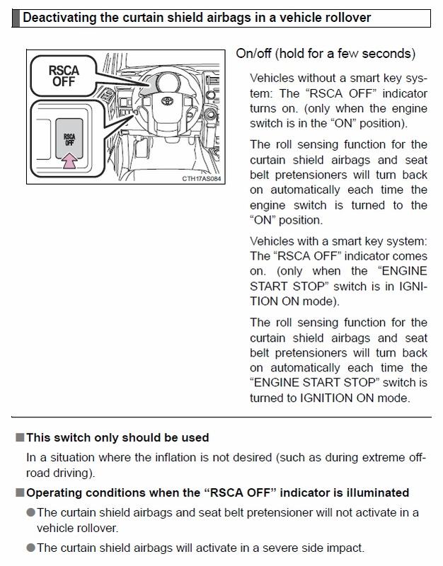

I got curious and looked in the manual and figured I might as well just put this here so all the information is readily available for those who don't like to :rtfm:
