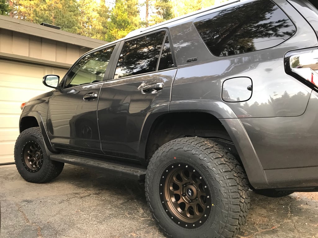

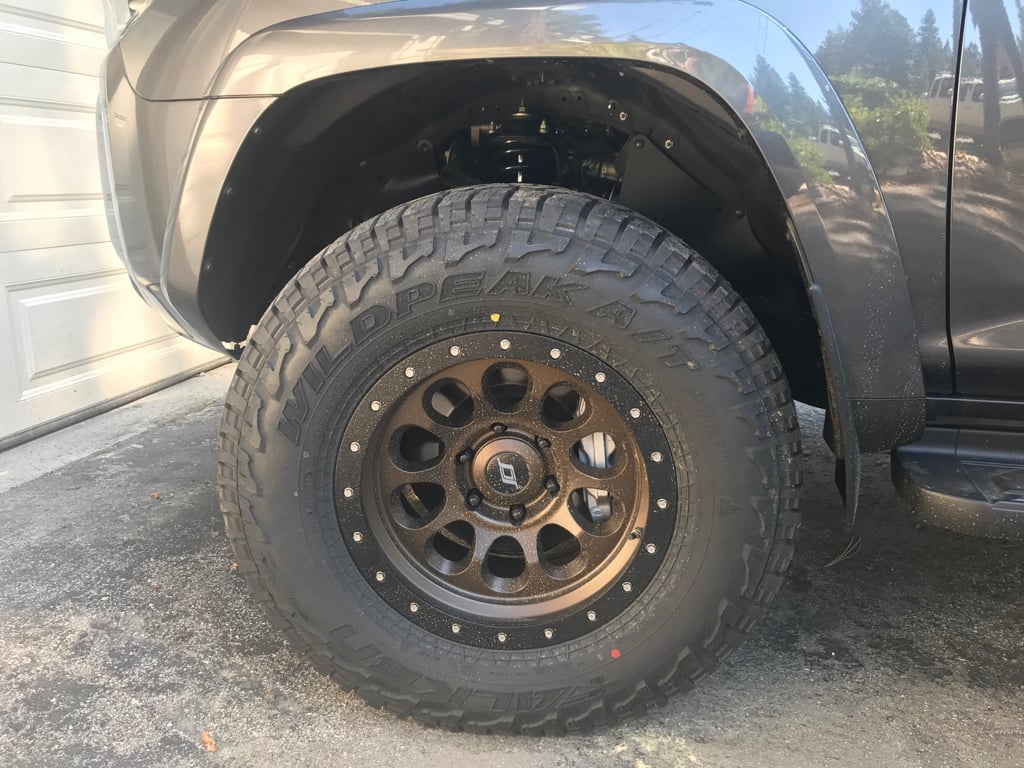

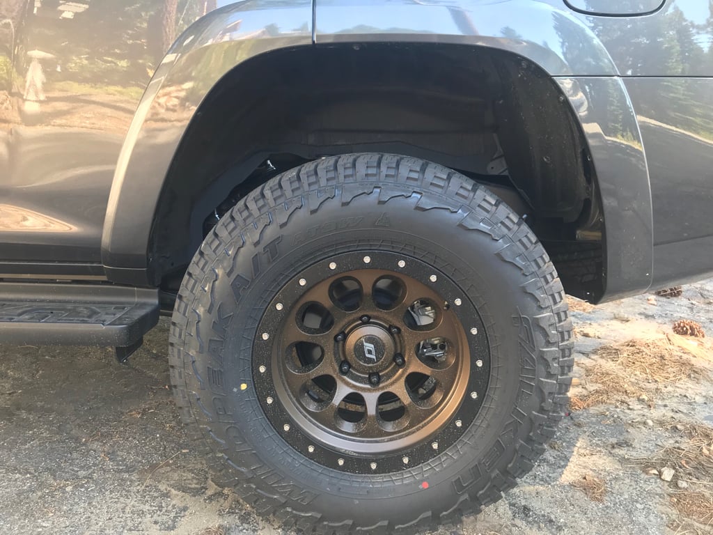

I am running the 285 70/17 Falken Wildpeak AT3W in P-rated on SCS RAY10’s.
The Ray 10’s in 17 X 8.5bolt pattern 6 X 139.7backspace 4.30"and offset -10mm.
I have Bilstein 6112 front set at 2.5”
I have Bilstein 5160 rear with Icon 2” rear springs
Stock UCA’s
Alignment worked well all within normal tolerances
Front: slight fender rub had to shave the front fender and push the fender liner forward. Front mud flap rubs in reverse at full articulation. Will need to remove or dremel.
Rear: no rubbing at all
Side: does not stick out past the fender.
No BMC needed I would like a 3” lift in the front to make the body more level and have a slight inverse frame rake. But I did not want to replace the stock UCA’s right now.
No rub
