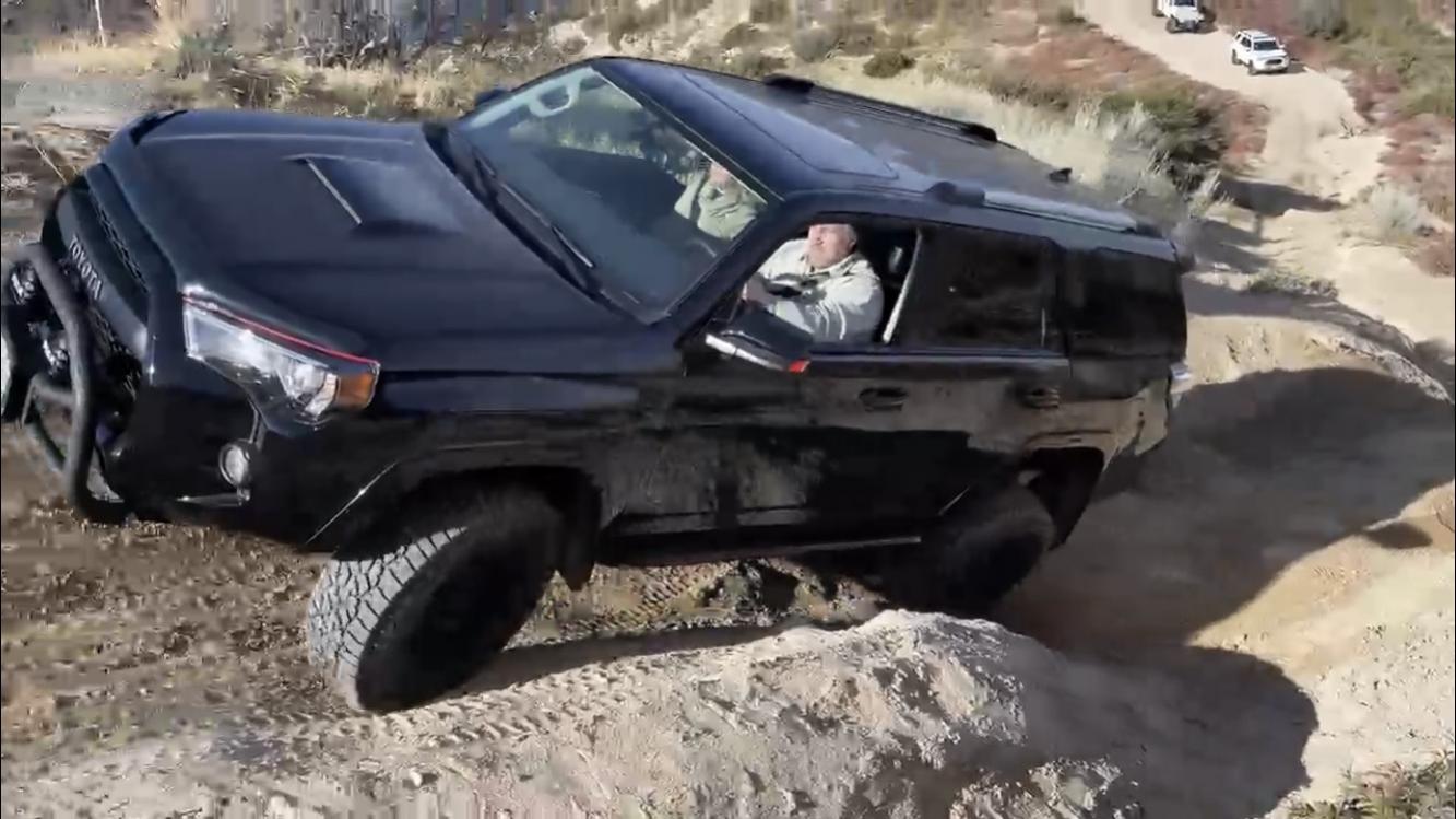

I’m running 285’s without having to do any mods.
I do have a 2.5” Daystar spacer lift front n 1” rear.
My KO2’s have cleared just fine, even off roaring w articulation of the suspension.
