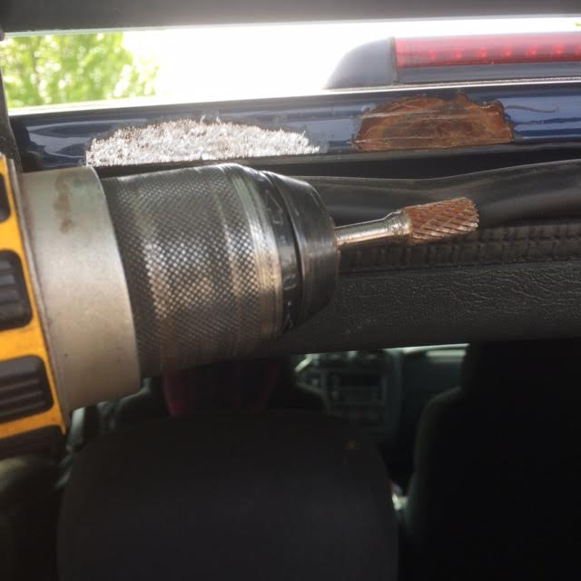

I recently did some de-rusting, on my 4x4 Jimmy / so it will sell quicker.
A $20 tool, I found works extremely well / with results, similar to sandblasting:
- a 3/8" de-burring end mill / diameter & tool bottom, chews up rust...very sharp flutes (and didn't go dull)
- than I hit the minor rust pits, with Loctite Extend / converts the corrosion, with deluded phosphoric acid (prior to paint)
The end mill takes the rust down to clean metal, surprisingly quick / just wanted to share tool, its a true labor saver.
