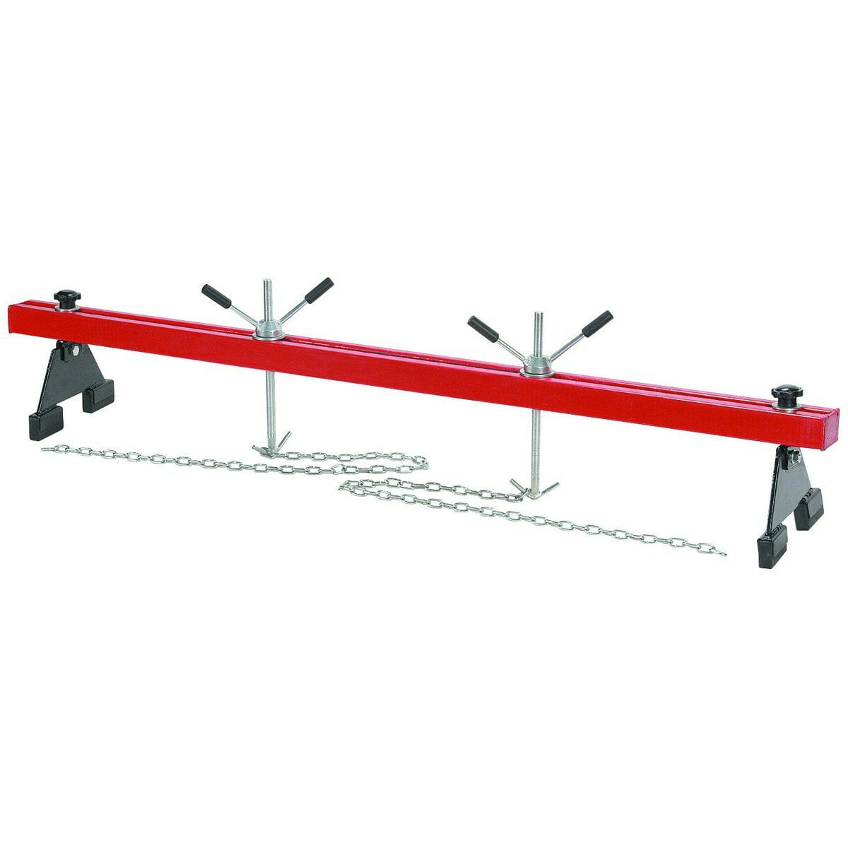

I had thought about using one of these to support the engine

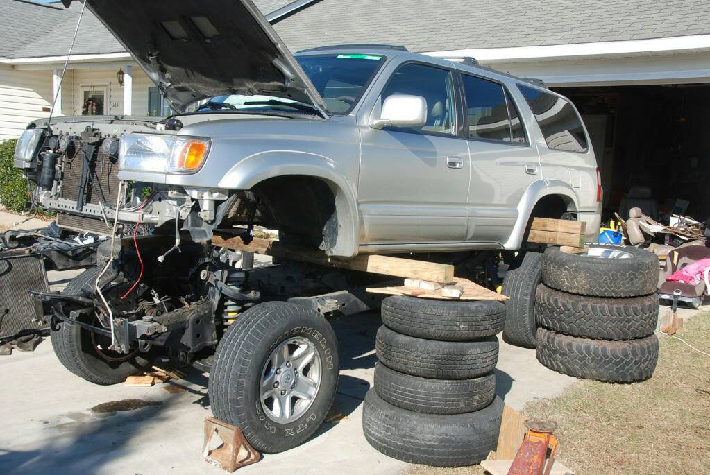

Then if there was a way to lift the body off of the frame without removing the axles. I saw this in the V8 conversion thread by Singtoe.
Page link: http://www.toyota-4runner.org/3rd-gen-t4rs/94282-v8-conversion-10.html
It looks like he jacked up the body using the Fram as a base and then stacked lots of plywood scraps until he reached a height where 4x4s could be placed and rested the body onto old tires.
Don't get me wrong. What you have done is Awesome and an inspiration to us all. Now if there was a way to mount the frame like you would an engine block so it could be rotated freely, that would save a lot of frustration.
Sent from my SM-G930T using Tapatalk
Well, I don't have a dozen old wheels. I have jackstands and a crane. I still don't know how you deal with the engine. Singtoe wanted to pull the engine and left it on the frame. The nice thing about my method is the engine/trans/TC stays where it is and you don't have to mess with wiring, A/C and a whole bunch of stuff. But thanks for the idea.
As for flipping the frame, I got good at it. Three minutes with a 2x4 and a '61 Olds station wagon bumper jack.
