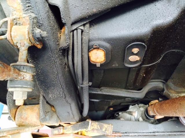

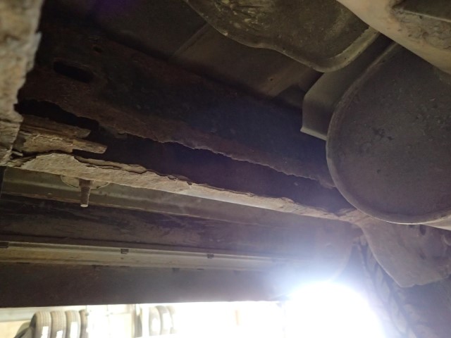

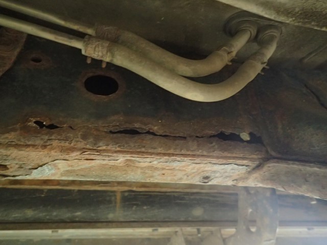

A few months ago, while I was getting an oil change, the tech brought to light the frame rust of my 2000 t4r (attached pictures).
Not sure if it's something that's worth fixing, but it's inevitable I'll eventually need to replace the vehicle. Maybe now, maybe in a few years... but if I keep driving with this rusted frame would I be putting myself and others in danger? I'm not sure how much rust these frames are designed to withstand.
Wondering if there's anyone out there who also had to deal with the infamous frame rust issue and how they went about moving forward after seeing it in their own vehicle.

Hi neighbor:
I'm 401 West of Toronto, a few hours (south of London) / so I will tell you, your rig was never wax-oil spray undercoated...to bad.
- now structural is too far gone, in the province of Ontario, Canada
- implemented 2016 safety check standards, don't pass welded up frames / repaired frames not legal here, any more
- might be a death trap, in the eyes of the ON. Law now / time to get it off the roads
Never have to deal with those rust through issues, with $110 annual rust proofing...but T4R neglected too many years, in a winter rust belt.

It's done man. I wouldn't even fix this or try too. Part it out and get a new one that's rust free. If sucks I know but there's no way to make this to pass inspection. If you wanted to make this off-road only then we can talk.

Way too far gone. Unfortunately it is time for a new truck. Obviously if you are buying a used truck take a real good look at the frame and make sure you get a completely clean truck underneath.
Holy geez dude. Mine failed inspection for about an inch-sized hole in the frame in one spot, which wasn't a big deal to patch. This... Wow.
