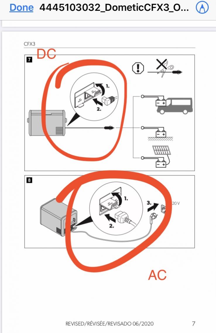

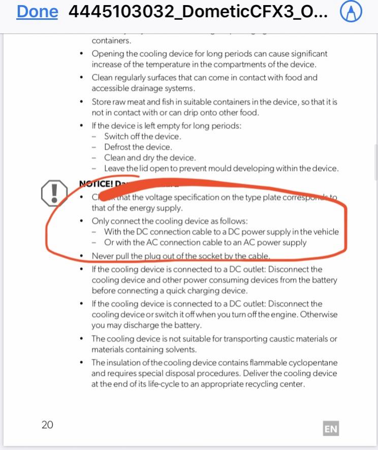

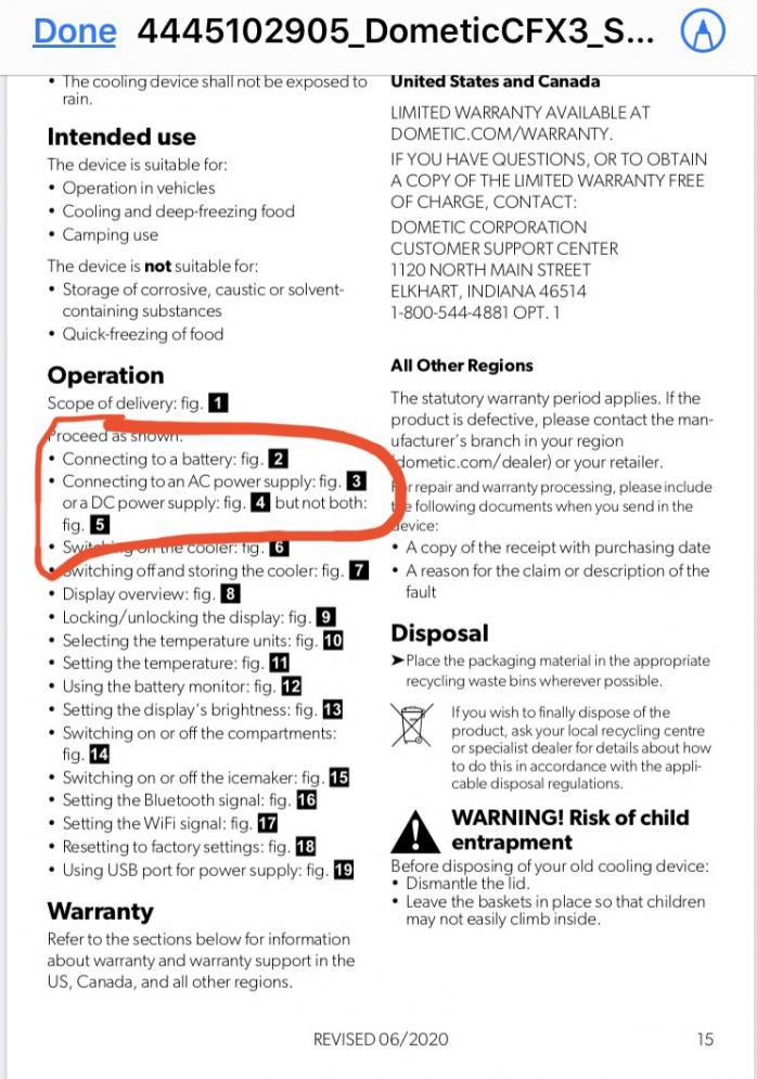

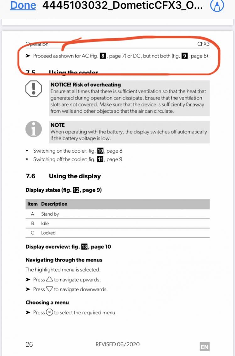

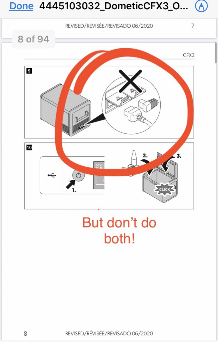

They have made some changes to the user manuals for CYA reasons and uploaded revisions on their website. But who reads those? Take a look.
