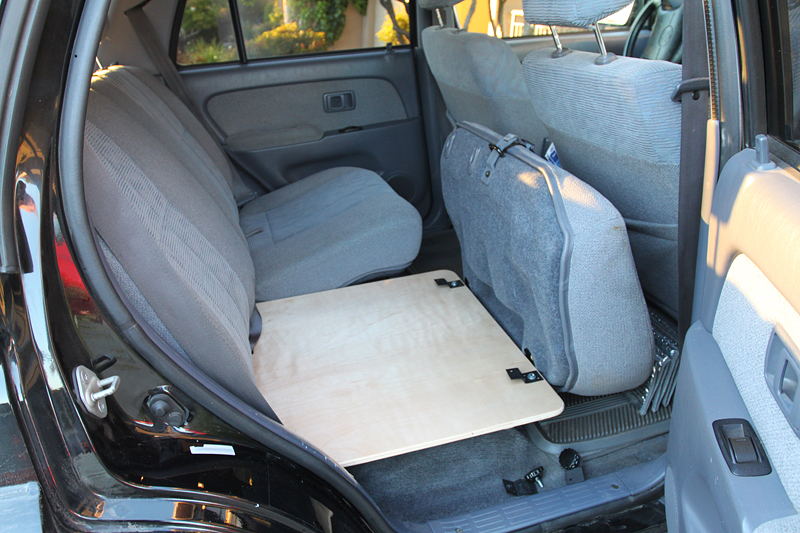

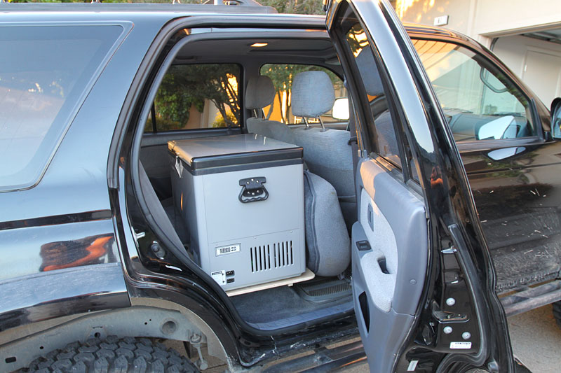

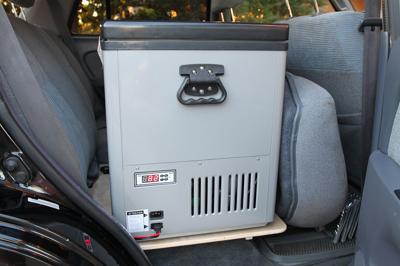

I mount mine in the rear passengers side seat, this way I can sleep in the truck and still have the cargo hold available for storage.

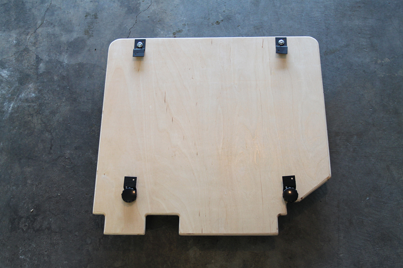

Here's the mounting plate.
- Matt
that's nice, Matt
any chance you could please post some dimensions of your mounting plate?
Thanks. Unfortunately I don't have specific dimensions, I just made a template using cardboard and then transferred it to 1/2" cabinet grade plywood.
- Matt
^ I like that. I'm still looking for something to mount in the back of the truck. I won't be sleeping in the back because I have a RTT.
