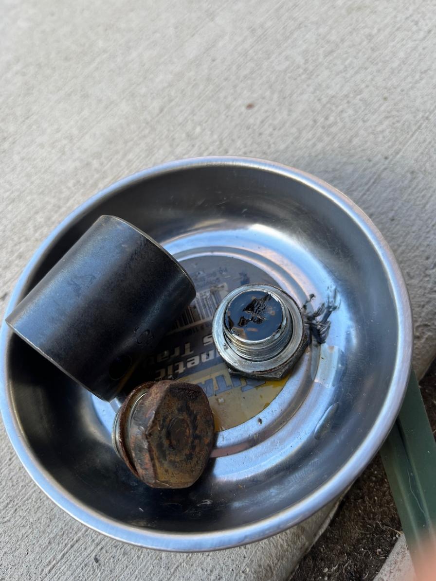

Time to replace my rusty old drain and fill plugs. Finding part numbers online these days is ridiculous.
Pretty sure the fill plug is: 90341-A0002 but I’m going to my local dealer to verify. No idea of the drain plug.

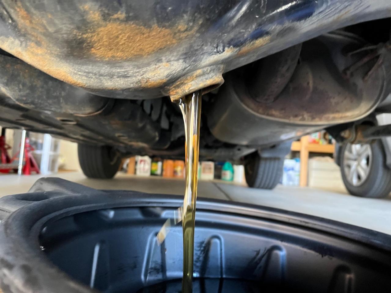

33,000 miles on this fluid and it looks clean. Not much gunk on the magnet.
Edit:
Rear Diff Fill Plug: 90341-A0002 (Straight Screw Plug with Head) $8.64 MSRP.
Rear Diff Drain Plug w/magnet: 90341-18057 (Plug Sub-Assembly with Head Straight Screw) $15.95 MSRP.
My local will sell at MSRP online for pickup but wants 50% more for a in-person sale.
