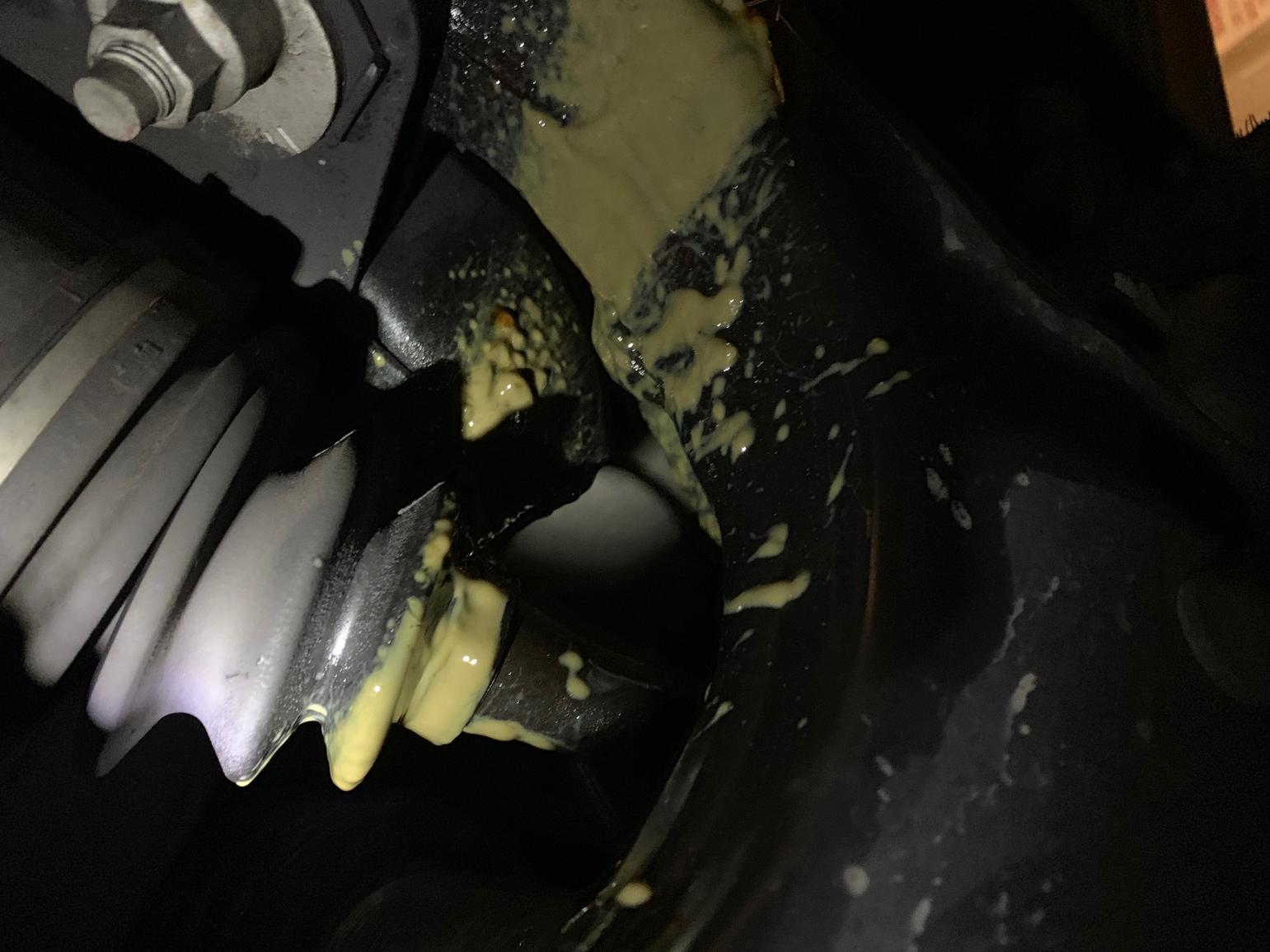

Might have been a blessing in disguise, but my car battery died (it was due) when I let it sit for 5 days. While replacing the battery, I discovered I have a huge leak from the front end of the car. Looks to be coming from the passenger side axle seal. The car is garaged for now as I do not want to dive with an empty diff.

Below is a pic of the leak. After watching this reboot video, I think my CV is bad and not the axle seal as the color of the grease is matching the toyota grease in the inner boot:
https://www.youtube.com/watch?v=vcCT4UgFUTw
Thoughts?

Definitely looks like CV grease and not gear oil. Did you check the gear oil level in the diff? I suspect it is fine.

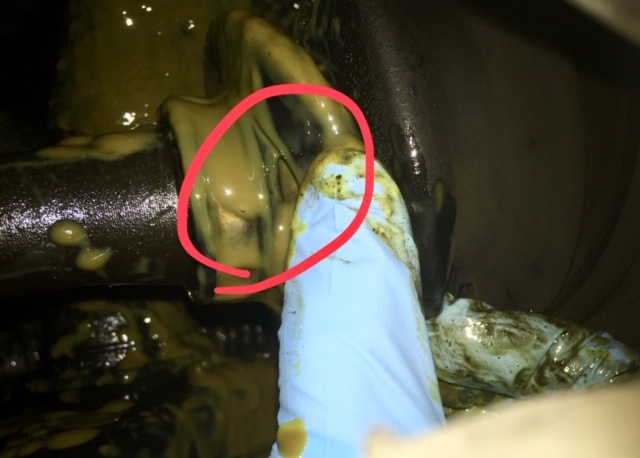

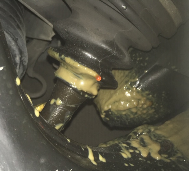

Update: So its definitely the CV boot. I have no idea on the history of the car, so I plan to replace the CVs. What is the red fluid at the tip of the grease? Does the grease separate like that? Car has been parked for a week.

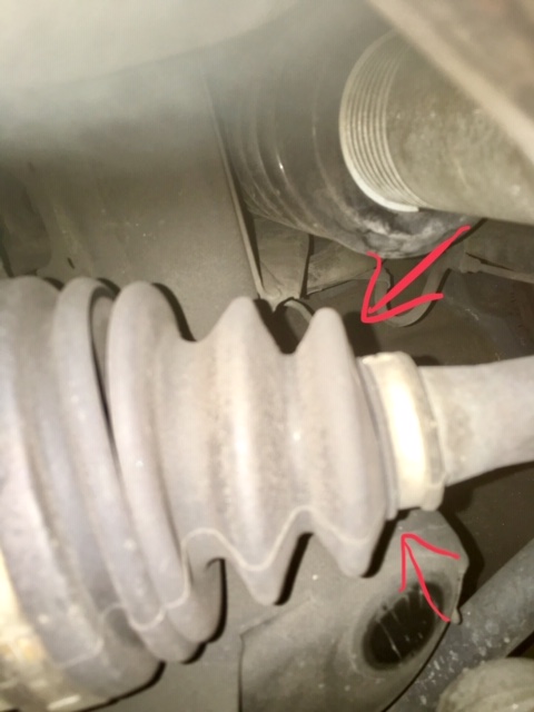

Looking at the driver's side CV, the boot is bent awkwardly as it is compensating for the angle. I do see this as a potential failure point in the future. I really do not care for the 2" lift, but I could not find a good set of rear springs, so I was sort of backed into a corner with OME 2906 springs when refreshing my suspension.

That red fluid is probably coolant. There are a bunch of hoses and plastic fittings at the back of the engine that apparently can crack and leak. Mine leaks a little from there as well, just haven't gotten around to fixing it yet.
