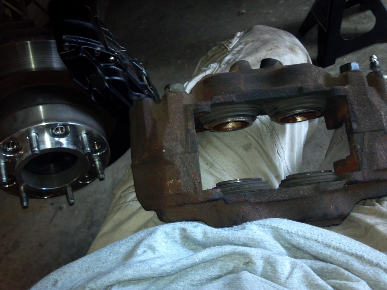

Just wanted to add a little bit of my experience with this here.
In Jan of 2010, my front oem calipers (13WG) had a frozen pistion in each, so I swapped them out with the larger 13WH, along with the correct/larger rotors (Just required a slight modification/manipulation to the dust shield). They were replaced with the reman'd calipers from RockAuto.
Recently I noticed my braking wasn't what it should be, stopping distance had increased, and was a lot less smooth. One night after work last week, I quickly shined a light on the pads through the wheel and could see they were worn, so figured it was time to swap the pads.
This past weekend I stopped by Advanced Auto and picked up the pads, and headed home to swap'm out. When I got to pulling the calipers off, I noticed the pads weren't worn evenly, and when I went to compress the pistions, two on each caliper was frozen. Oh yay! So I reassembled everything and CAREFULLY drove to NAPA and bought the reman'd calipers there. $114 + a $50 core charge per. Went home and swapped'm out, bled the lines and can once again stop on a dime, and smoothly.

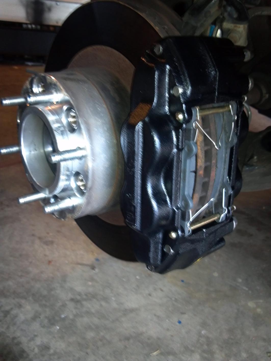

I must say too, these NAPA reman'd calipers look sooooo much better than the ones I got from RockAuto. Nice protective coating, and the materials look better as well. Here's to hoping I'll get better luck with these. I'll be doing some of the [hopefully] preventive tips I've seen floating around here as well, like greasing up the retaining pins and such every so often.

In front caliper there should be just one anti-rattle spring in each caliper. I noticed on FRT's pic 2 of them. Is there any benefit of placing 2 clips or just OCD?
OCD on my part I believe. =)
I noticed having just one that the pads weren't pushed back against the calipers evenly/perfectly, so I added another spring to even it out. And who knows, maybe the little bit of back pressure it'll add will help to prevent the pistons from freezing up again (doubtful that'll make a difference). :)
