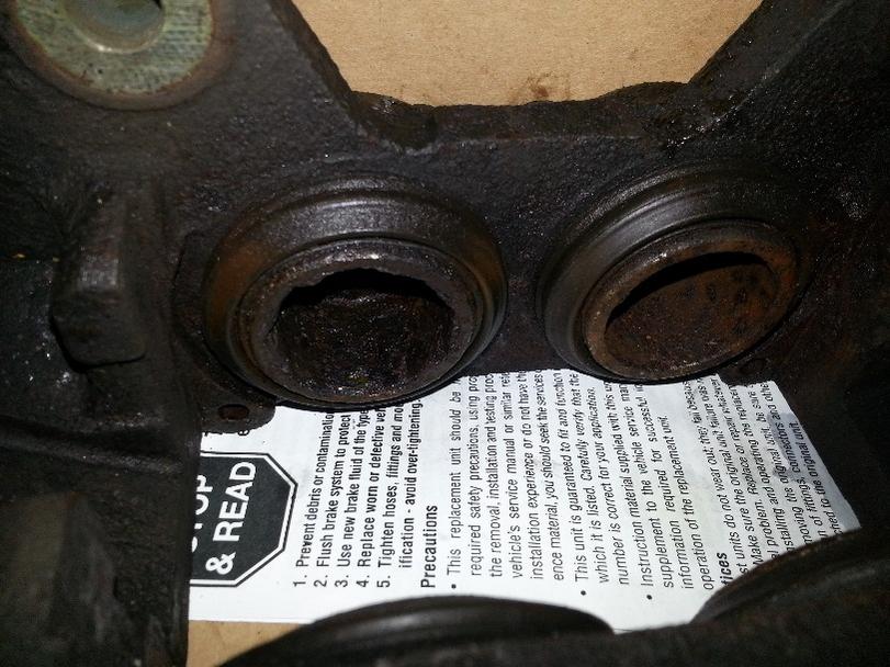

I heard a slight squeal last night with the windows down; jacked up the front driverside wheel and it was way too hard to turn by hand. The pistons aren't frozen yet, but they are a corroded mess. So I think I'm just going to go ahead and get some remaned calipers and pads from Napa. Is anyone replaced rotors as well while doing this?
i replaced with advance auto reman calipers painted in silver, brembo rotors, TRD brake pads, and Valvoline synthetic brake fluid, awesome combo !!!
both of my fronts were seized on the lower inner piston.

From my experience and from what I have read it looks like the problem with the calipers is in the basic design/materials.... Remans just give you more of the same so there still is a fair chance you might have more replacements in your future.... When I was deciding what I would go with the thing that attracted me to the NAPA brand was that they are lifetime warrantee (keep your receipt!) and that they were painted/coated with something that seems to handle the new England winter fairly well..... If/when they fail in the future I can get replacements for free....;- )
