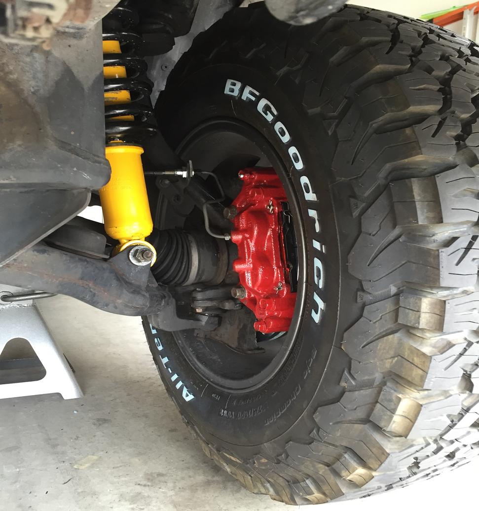

I'm not calling you a liar, but if you put a pad across the two pots where the arrows are pointing and compress those ONLY, the other sides pots are gonna extend.
To the OP: Get a 1/2" drive torque wrench/breaker bar.
You are correct
So in theory factory spec would be both pistons on each side flush against the caliper. so when one side is pushed in the other side is pushed out.
So when you put the old pad against The pistons that are popping out and push them in, the pistons on the other side which most likely are going to be pushed IN the same anount the other side is pushed OUT which will bring it back to factory settings
Im no expert but since your saying the way i did it is not possible and i physically did it that is the only logically explanation i can come up with
Edit: after looking at your picture
The pods where your arrows are pointing to i never touch
I place the old pad against the actual piston itself and by the time i actually reach the pod your pointing to the pistons already compressed enough to slide the new pads in
Maybe thats are confusion idk i never thought about brakes as much as i have these last 2 days
