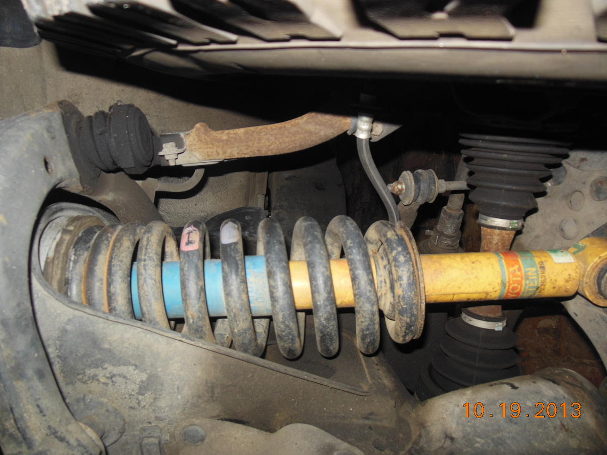

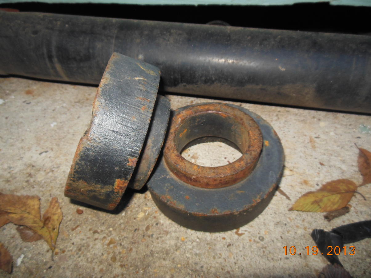

I had preload spacers on the 4runner springs and they were tight as hell. never absorb an impact on the road.
I now have 2000 4x4 tacoma springs and Bilestein strut and it is magnificent in absorbing bumps. Now I can go over bumps like driving a lexus car. The tacoma springs are soft and have a different winding pattern (coils are closer at the top and far at the bottom). If I add the same preloaders to this set-up do you think I'll get a lift?

What are you guys referring to as preload spacers? Since you can't preload the coil unless the shock is fully extended (drooped) all the time, which I would imagine would be bad since you won't have any down travel.

Do the Tacoma coils give any lift?

The coil pattern tells you they are progressive rated. The closer wound section at the top is softer, and the coil gets stiffer as the distance between them increases. I wonder why Toyota never used progressive coils on the 3rd gen when they used it on the Taco . . . silly Toyota
Wait....I didn't know the tacoma also had a progressive rate spring...but they dont add lift? I was looking at tundra springs but I would prefer <2" lift. Like 1.5" or so but with progressive rate. What is the length of the stock 4runner front spring?

Found the preloads I removed from my previous struts.
The strut/spring shown is from the tacoma.
