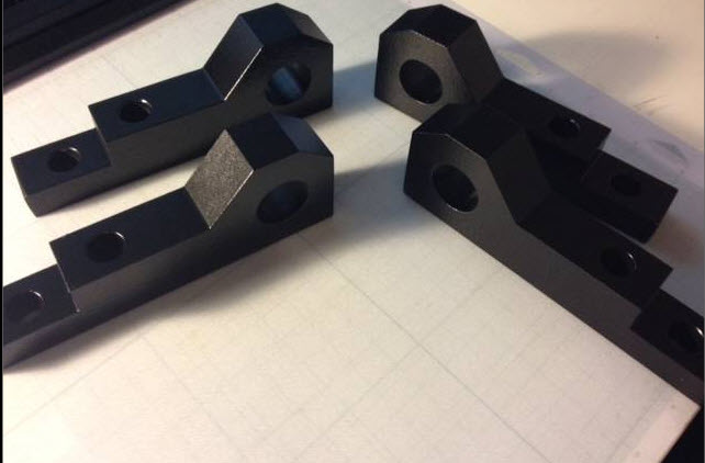

Two sets were complete today. One to NC and one to SC. Fabricating more brackets this weekend for those who want them. Let me know.

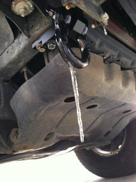

I have another set primed and ready for paint.
When installed they look like the picture; icicle is depending on the weather of course.
Great looking piece and half the price of the Sonoran Steel shackle hangers! But can someone please explain to me:
1. The hinge point is kinda high up there and there is a piece that hangs down right in front of it. Won't the D-ring hit whatever is in front of it if you were to put a hook or strap onto it and pull forward and damage something? In other words, can the D-ring be pulled perpendicular without hitting anything?

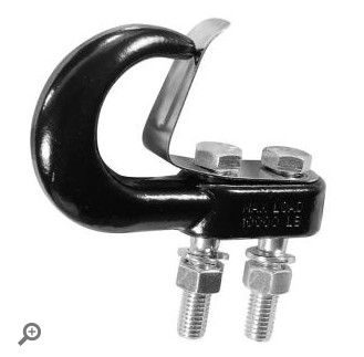

2. I get that this mount is a really beefy block of metal. However, I've been looking at something like this Keeper Hook which is rated for 10k lbs and is much cheaper. Is that not enough for a recovery strap extraction?
I was thinking the same thing.
There have been a lot of folks who have pulled others or have been pulled while 4Wheeling with these. It hasn't been an issue that has been brought up.

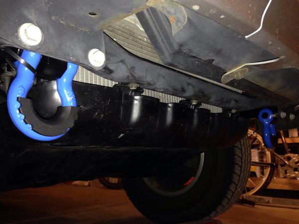

I added Daystar Isolators to mine to keep them from rattling against the frame. The reviews are good, they stay in place well, and they look kinda cool too! Available in black, red, yellow and blue.
