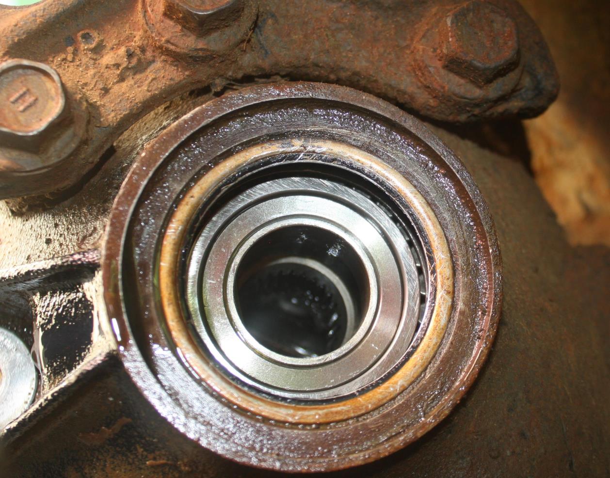

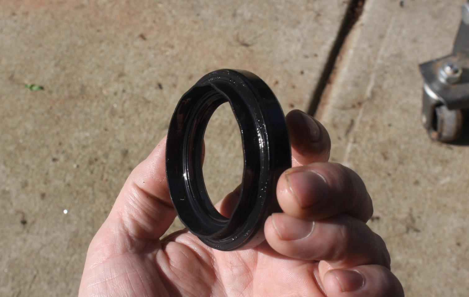

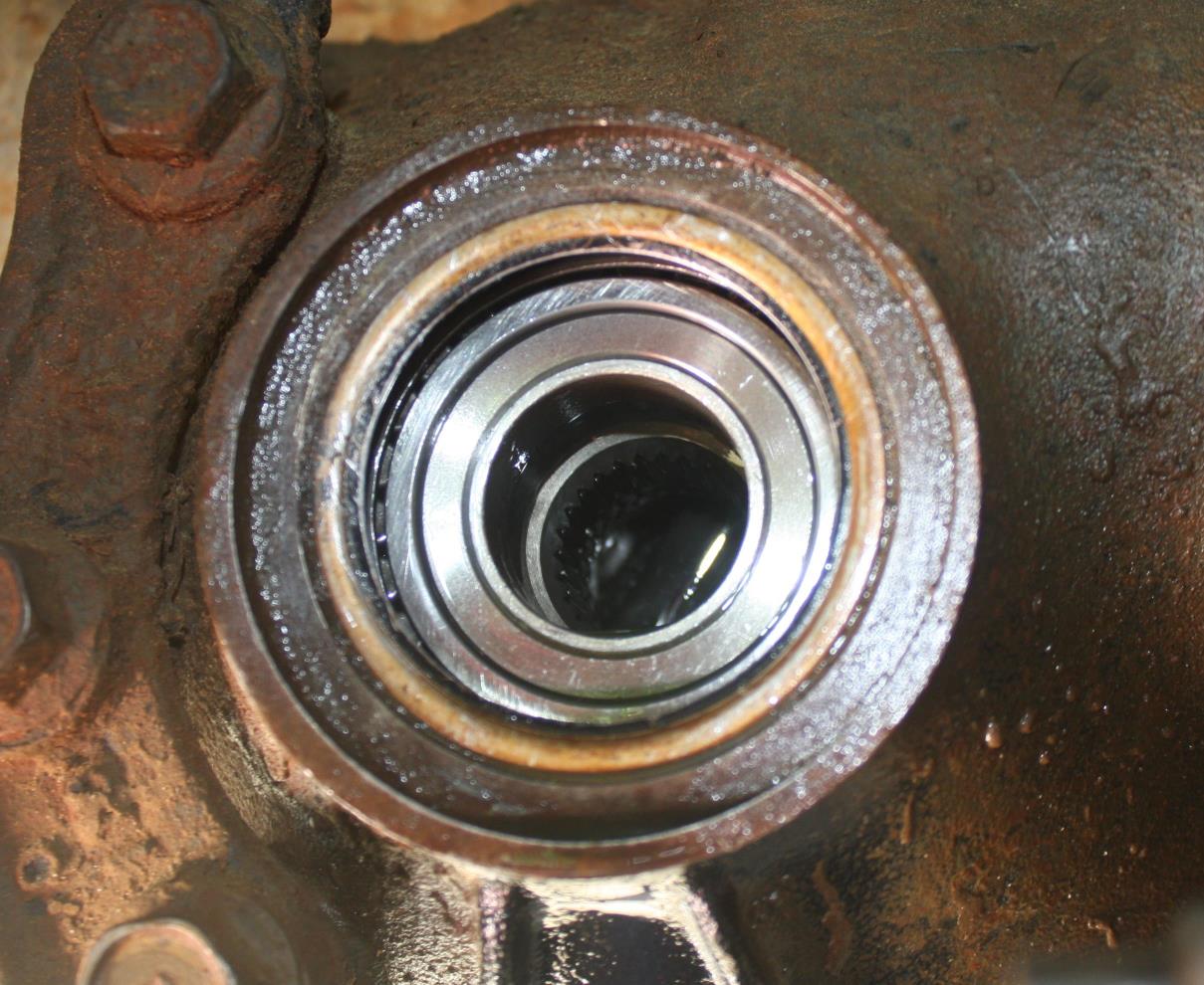

Looking for help with this same issue. Swapped the seal, which seemed different than what was in there. I chalked it up to there being a new part #, which there is. However, maybe I'm just dumb, but the seal doesn't seem to seat, just sits on the outside of the collar. There doesn't seem to be any "driving it in". So, put it back together and it still leaked. Took it back off today to look at it, with a spare handy. When I took CV off, seal fell off too. That shouldn't happen, right? Looked at it again, but I don't see any way to install other than what I'm doing. Put it in again, back together, still leaks.
Should have taken pics while it was apart today, but didn't. Maybe the old seal came apart & I didn't get it all out? Anybody else have anything like this?
I will post pics when I take it apart again. Maybe tomorrow. I'll try and take some as-is to see if anyone spots my mistake or issue.
When I woke up this morning, I looked at the diagram again and the part description and I think I may have the wrong part (or am trying to put in wrong place). My part desc says "SEAL, OIL (FOR DIFFERENTIAL SIDE GEAR SHAFT)".
Now that I am re-reading that, it seems that should go on the diff side, not the axle side? I wish I had taken pics when I took it apart originally. Ugh.
Any thoughts?
What I "thought" I was replacing was the outermost seal that comes in physical contact with the axle shaft. Like I said in my last post, even though I don't remember exactly what it looked like, I do remember that the part I bought (90311-47012)didn't look like what I took off. It is not fitting tightly on the diff housing, as I would expect it to. But, again, I may have in wrong place (or have wrong part, rather). Just confused now. Rainy day, so may take apart again shortly and take pics.
The new seal does look different than the original. Toyota updated and replaced the old seal. You have to seat it in properly or the fluid will just leak past the outer ring. Go buy a race and seal seating tool set and hammer that sucker in. The outer edge of the outer ring should be flush with the edge of the diff. Double check to make sure the metal ring from the old seal was pulled out before trying to reseat the seal.
Once I replaced my seal I had no more leaks.
Which side are you trying to replace? There are 2 different parts for driver and passenger side.
Part # 90311-47012 is for the driver side.
Part # 90311-47013 is for the passenger side.

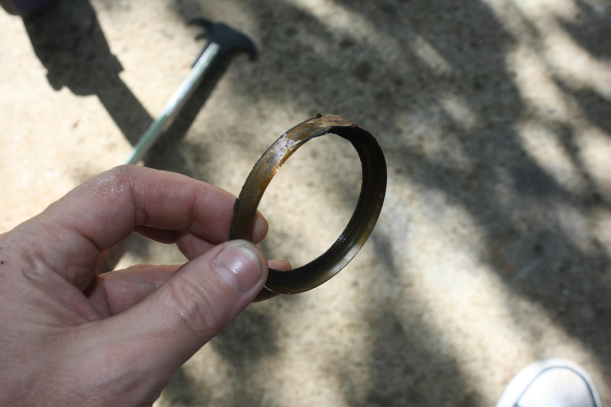

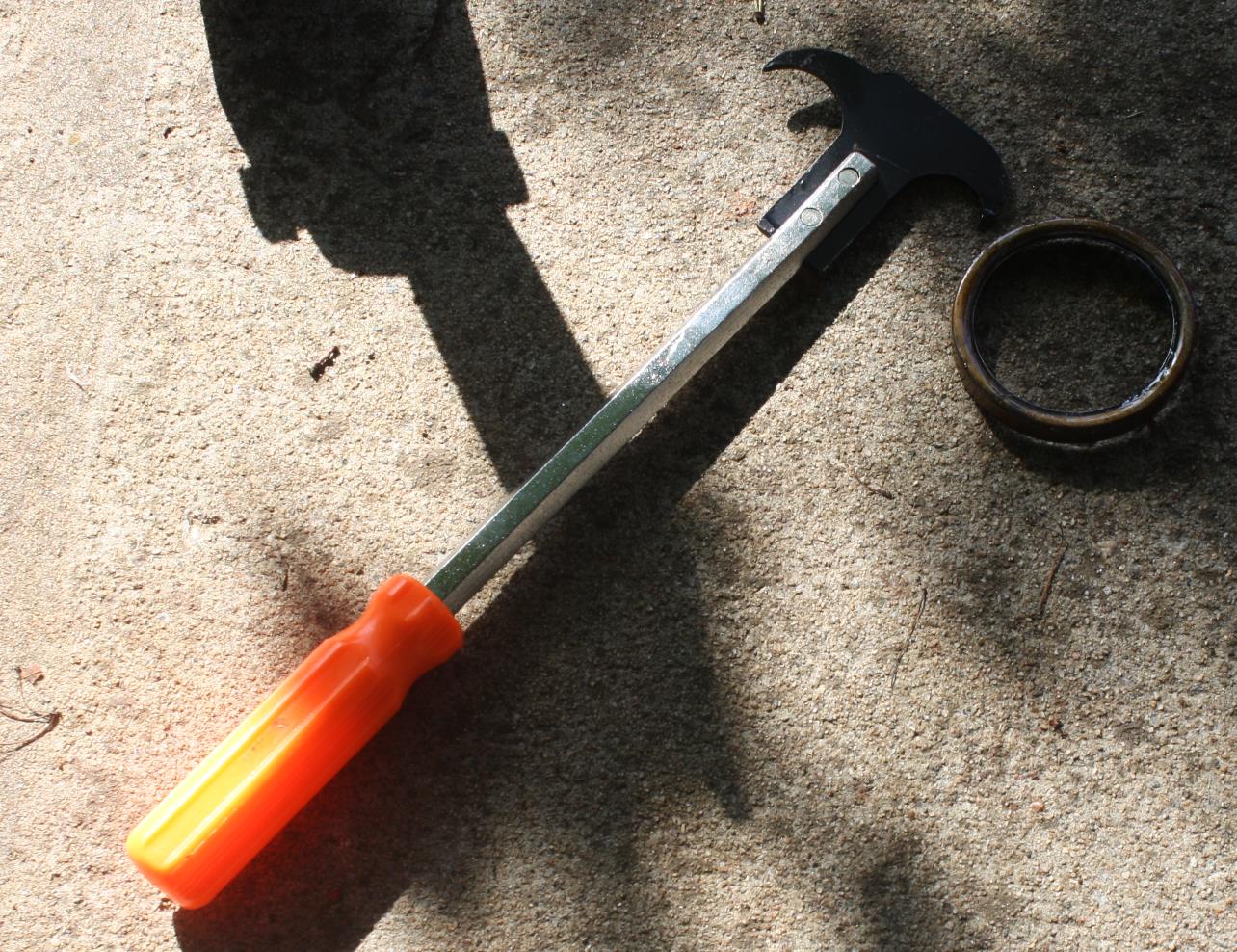

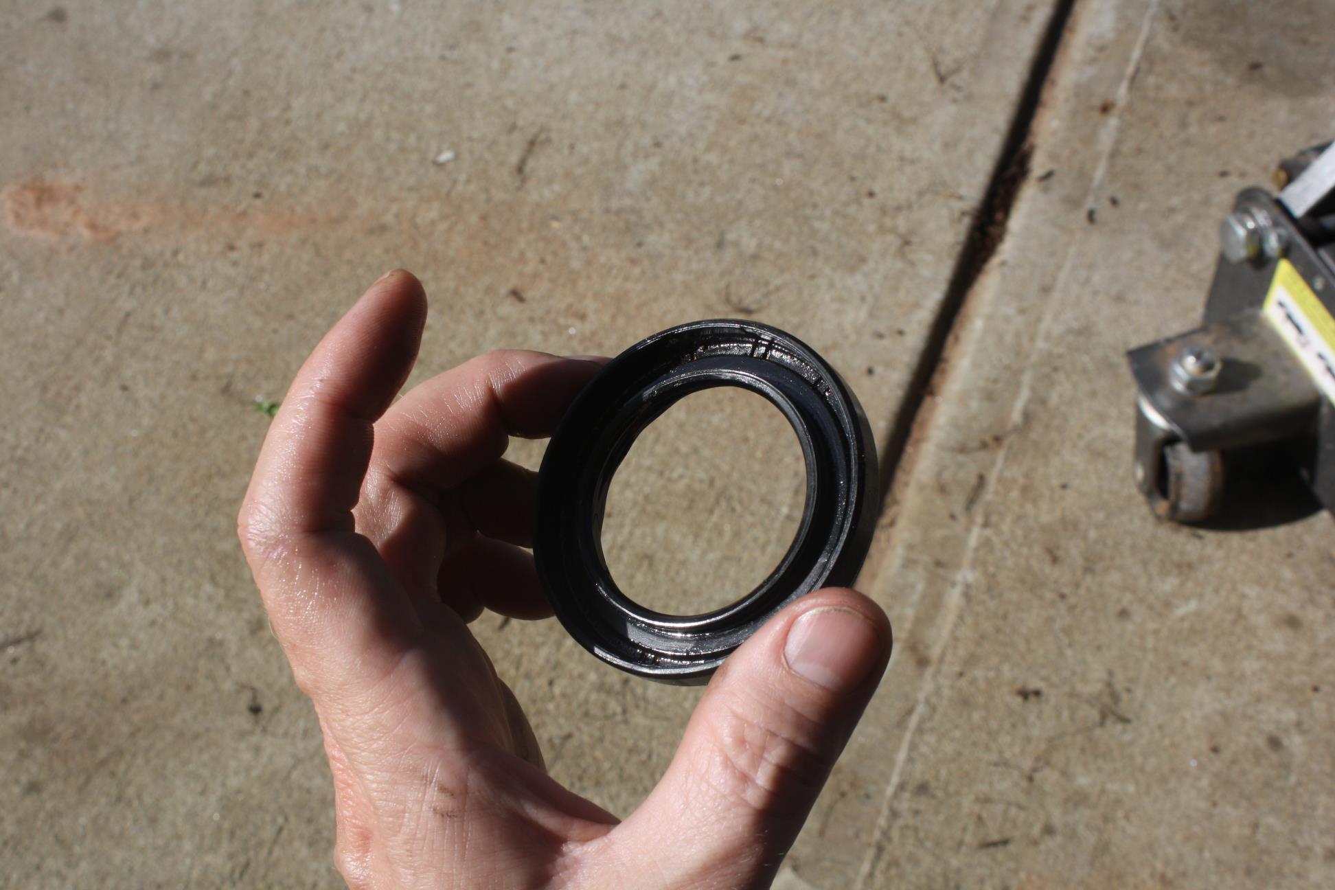

This is the old seal on the driver side.
I never did open it back up yesterday, but I am pretty sure the metal ring from the old seal is still in there. The new seal definitely wouldn't go into housing as I thought it should.
Thanks for the info! I will open it back up tonight, probably and hopefully solve this once and for all.
