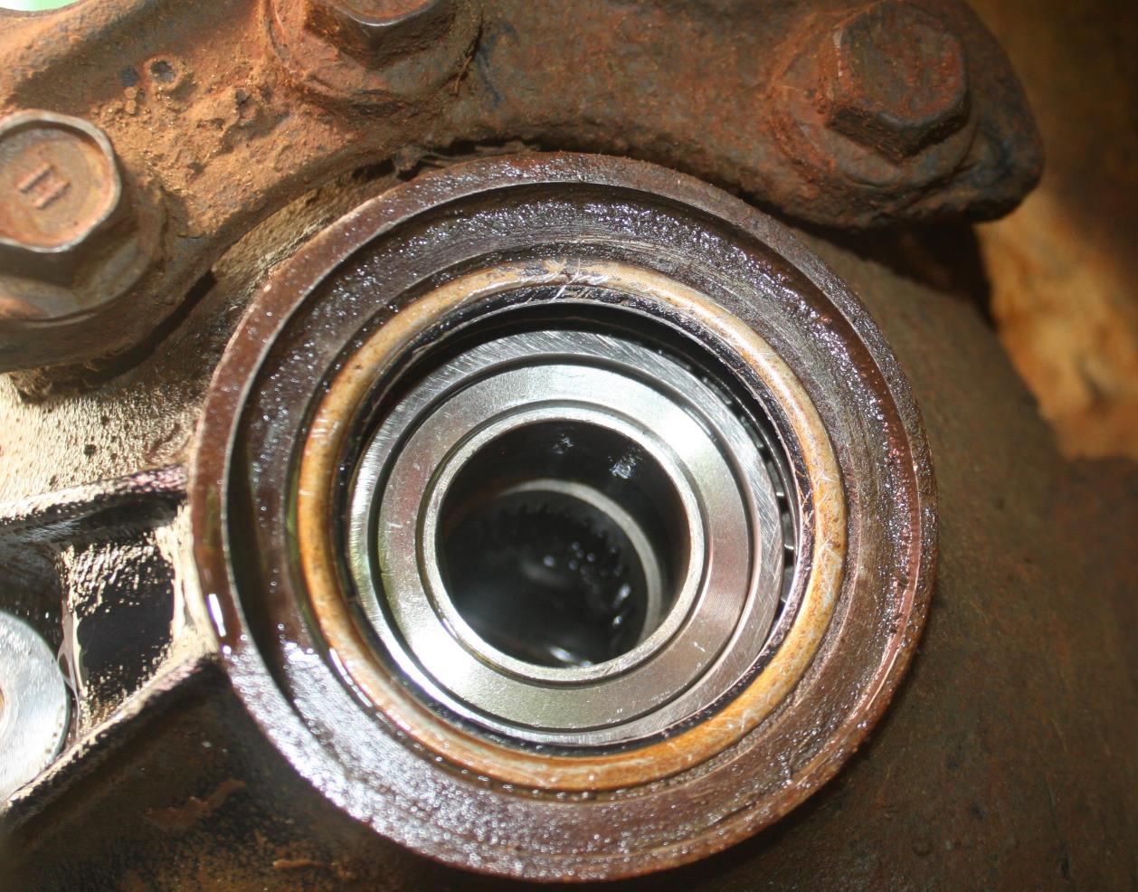

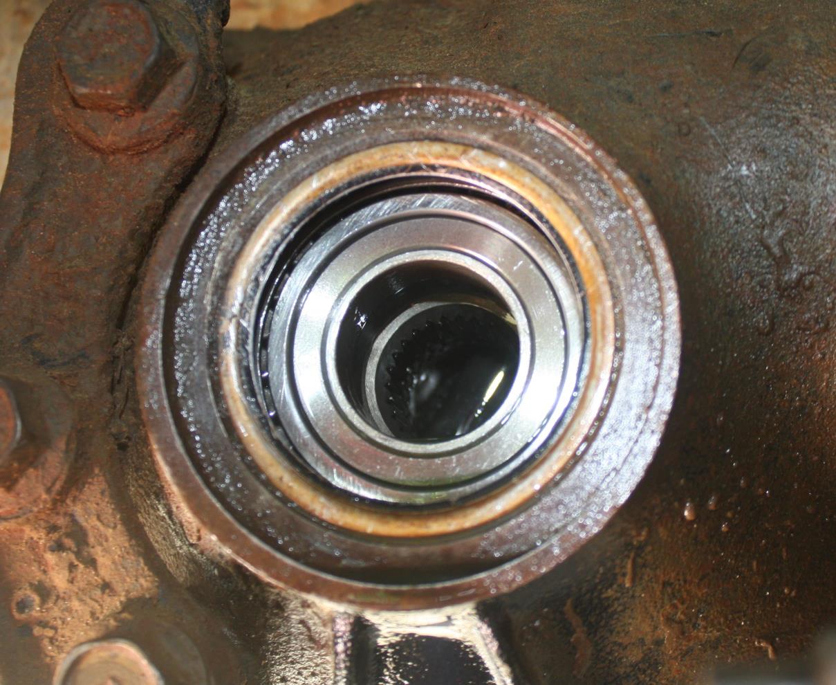

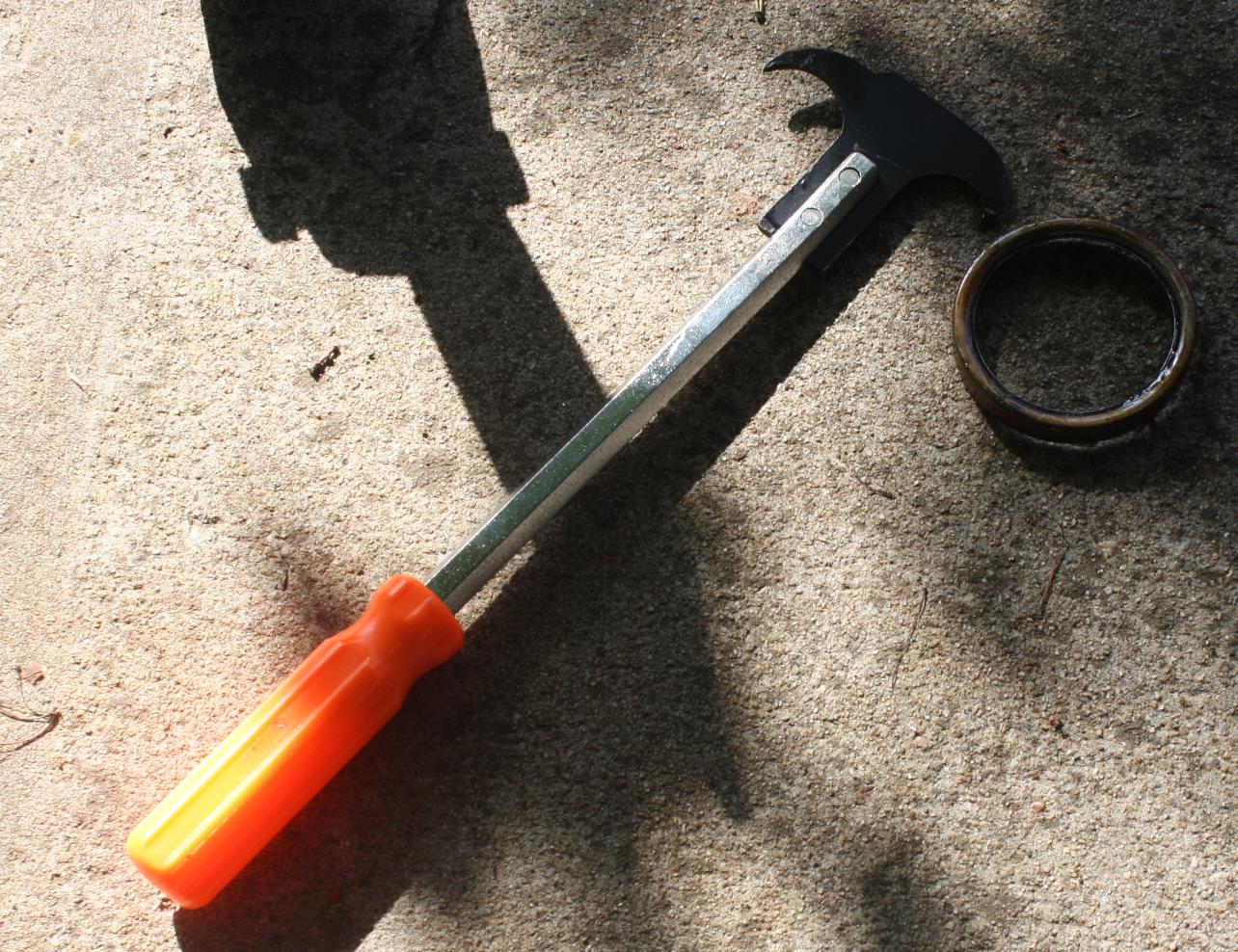

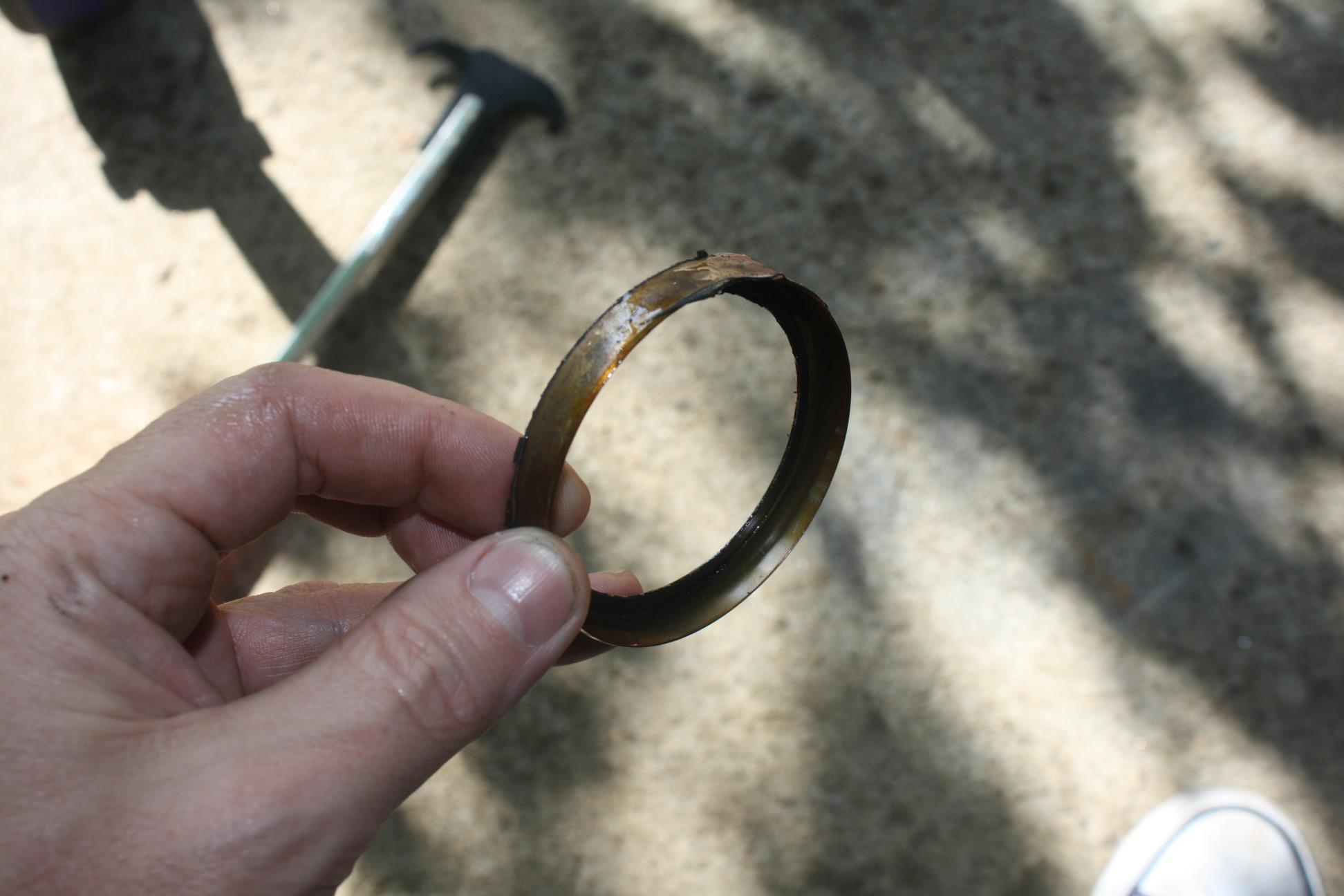

Yeah, that was it! There was still the metal ring from the old seal in there. Pics included.

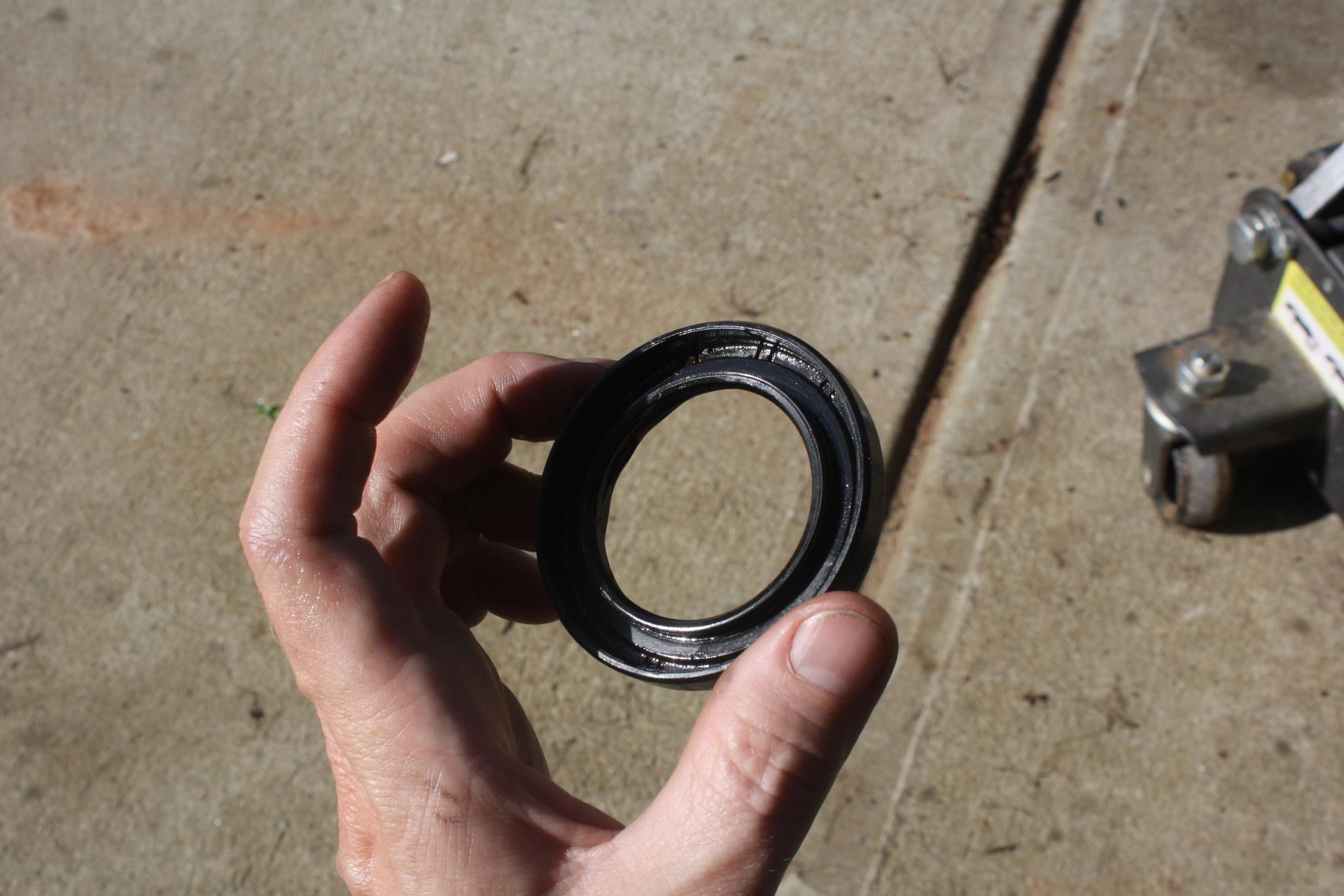

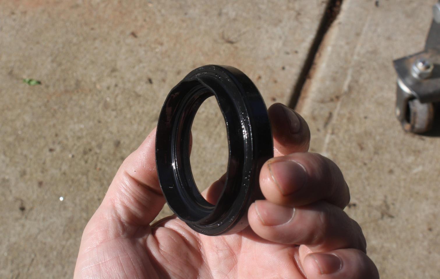

So, now, just to be sure...which way does this new seal go in? I would assume this way (this side facing out)...
since there are little baffles on this side, which I assume are there to keep oil in...
Can you confirm before I have to do this all over again??
Thanks in advance!
Just the opposite of what your thinking. The flanges face toward the CV axle. The "baffles" (as you called them) actually ride against the CV axle shaft to keep the oil in. It compresses around the shaft and and into the CV tulip housing.
Are you sure?? Doesn't seem the other side is made to drive against (to seat).

I guess it helps if you get all of the old part out before you try & install a new one.

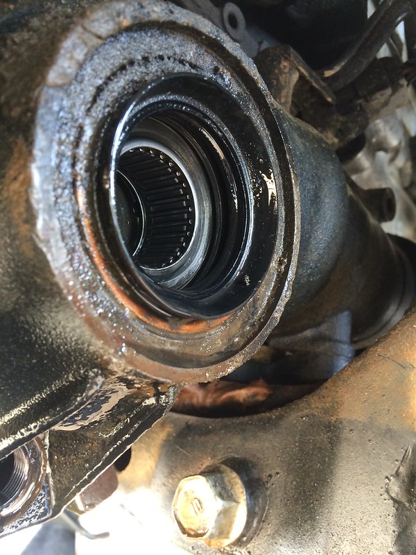

Just following up as promised, I believe I've been successful with the new seal on the passenger side. I was having a slow leak after installing toyota remanufactured axles, and we told by the dealership that I'd just need to go with a new seal and a OEM axle to get it to seal (as I described above).
Here's what I did, and I believe it was suggested as a solution in this thread, so I'm not claiming the solution as mine. The factory seal sits flush with the inner lip in the differential, where the axle meets up to it, and I measure that at 5.5-6mm from the outermost edge of the diff.
I pulled the axle, and looked at where the seal had been 'seating', which was a little further out than I expected.
I Test fitted a new seal to ensure that it felt snug...which it felt a little lose to me, but I also don't have the best feel for this being my first time replacing this seal, so I went with it. I didn't feel or observe any gaps, excessive play, and figured it wasn't meant to be 'tight' for the sake of wear and tear.
I pulled the old seal out and seated the new seal just shy of the recommended depth. I followed up with measuring to see where I was: roughly 4.75mm. Visually you could see that it wasn't all the way in, BUT by now means did it seem that it would come out easy...I had to seat it that far using a hammer and the right diameter race. I trusted I wasn't going anywhere.
I reinstalled the axle, topped off the gear oil, and went to a friends house about a half hour away, using both back roads and highway (35-70mph).
I checked the bottom of the diff last night, and this morning to find that my leak has, thus far, been fixed.
