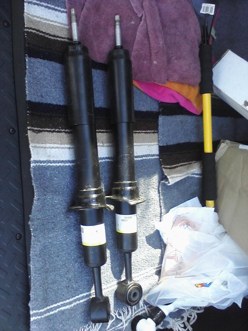

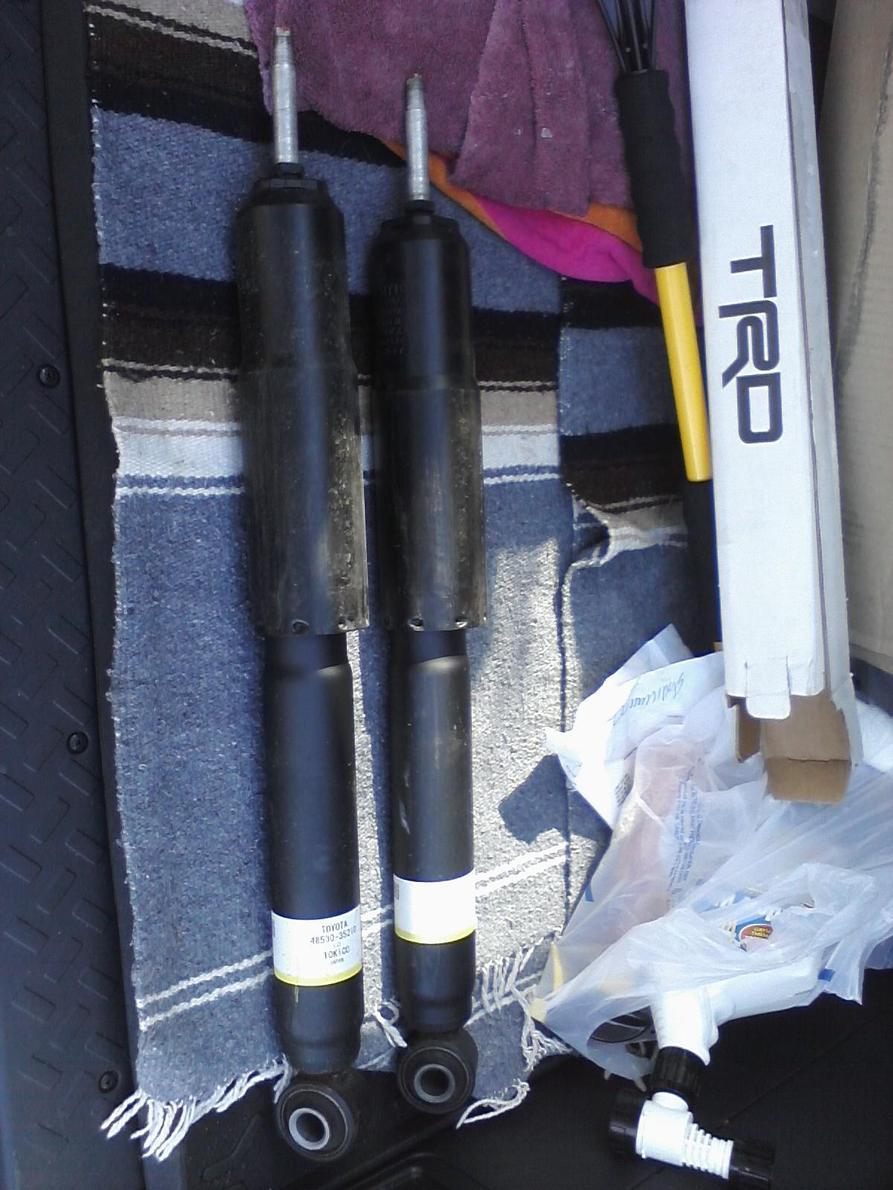

FJ OEM struts
Here is the pic the guy sent me. They seem to be in good shape
First pic is front Second is rear
