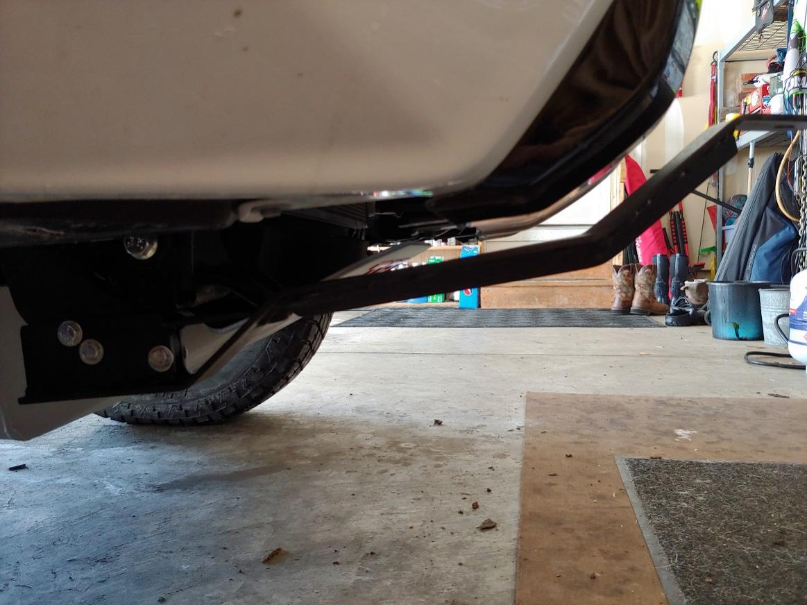

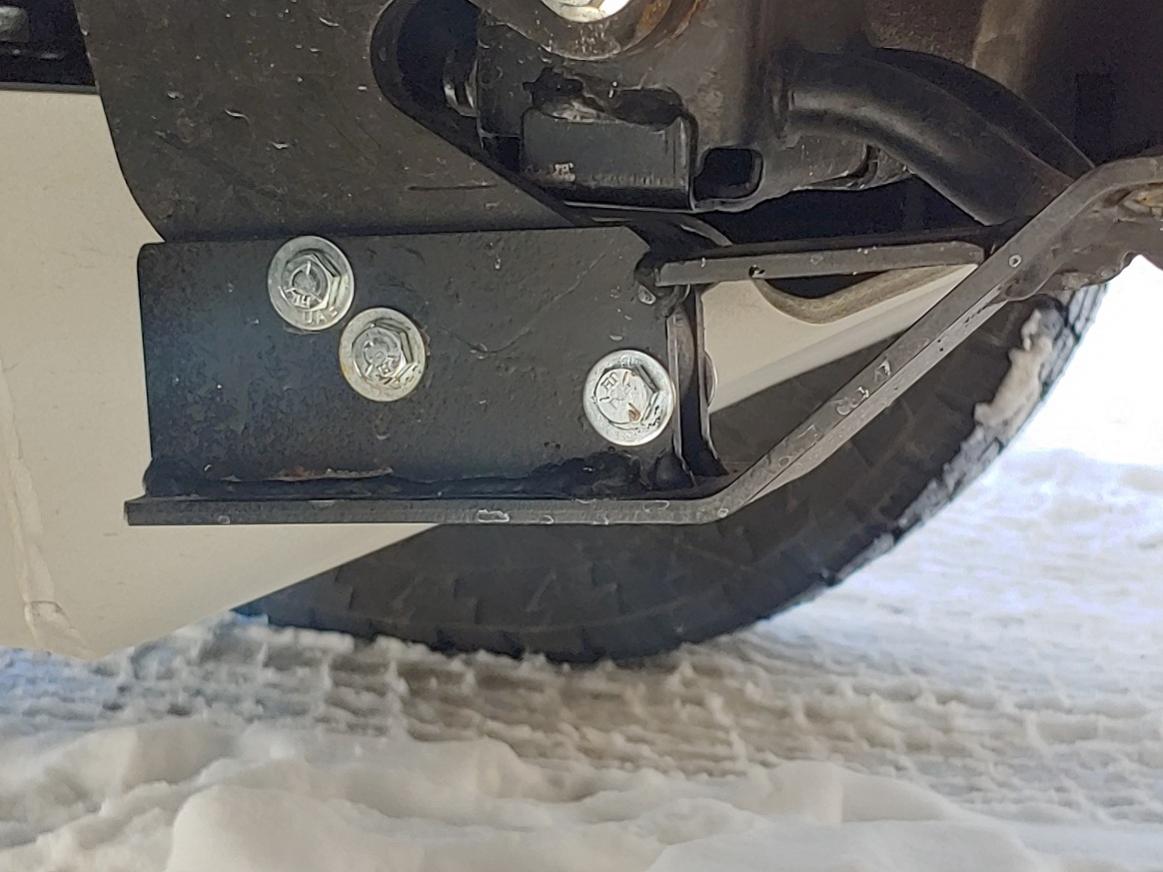

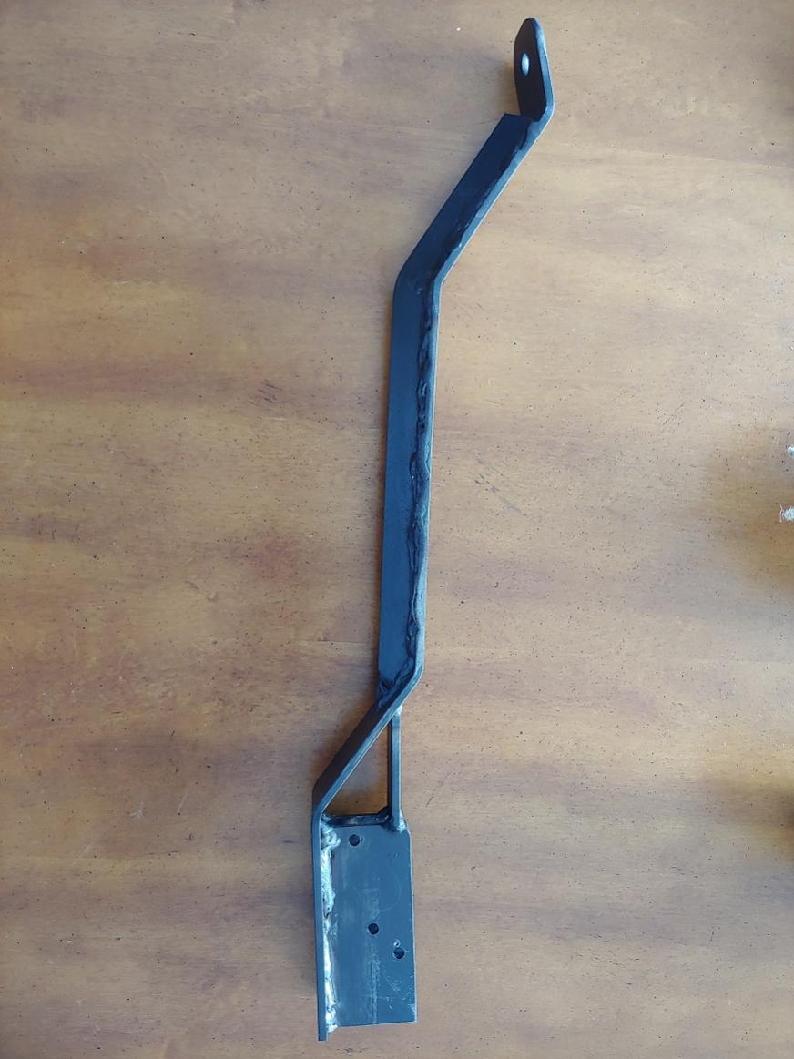

Mounts to Treaty Oak recovery point. Built it a few weeks ago. Won't say it will support my 225 lbs if I stand on the tip but it's not going anywhere. Gap between the bumper and mount looks huge in the pic but it's only an inch.

Not when the requirement is to have the flag mounted to the front of the vehicle.
This was easy to build. YMMV, of course.
