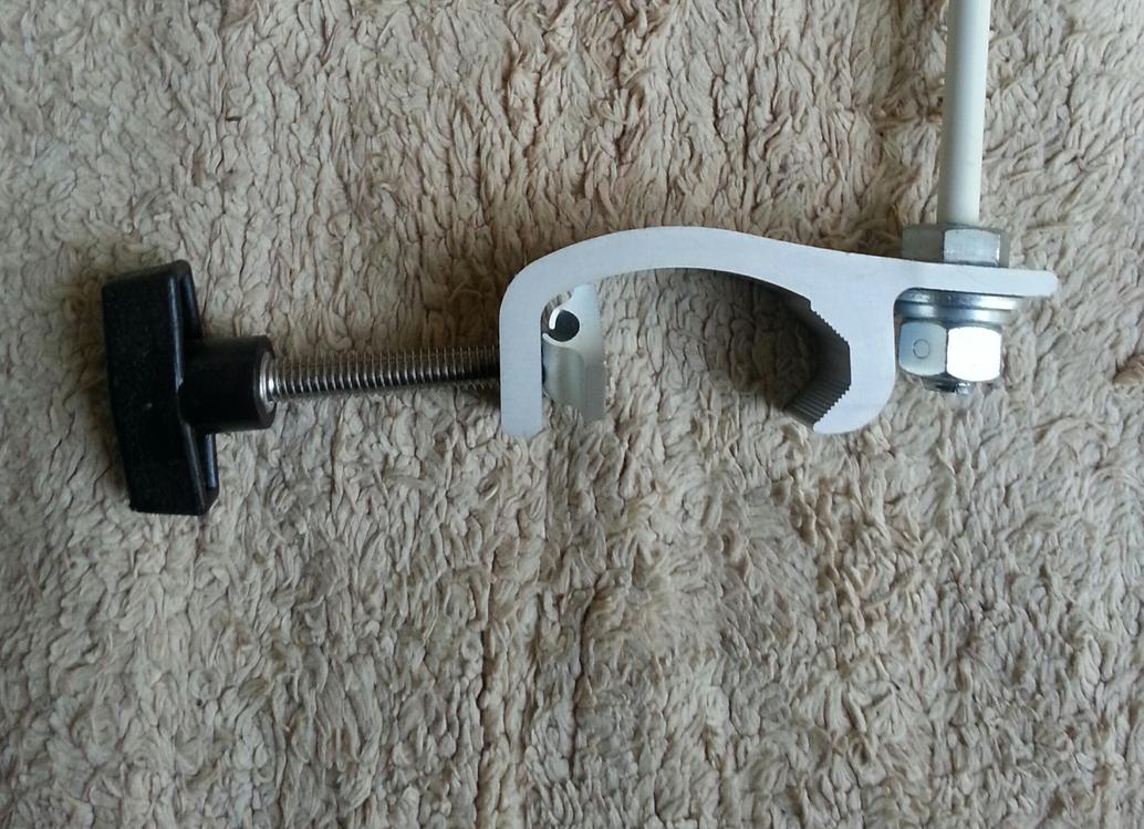

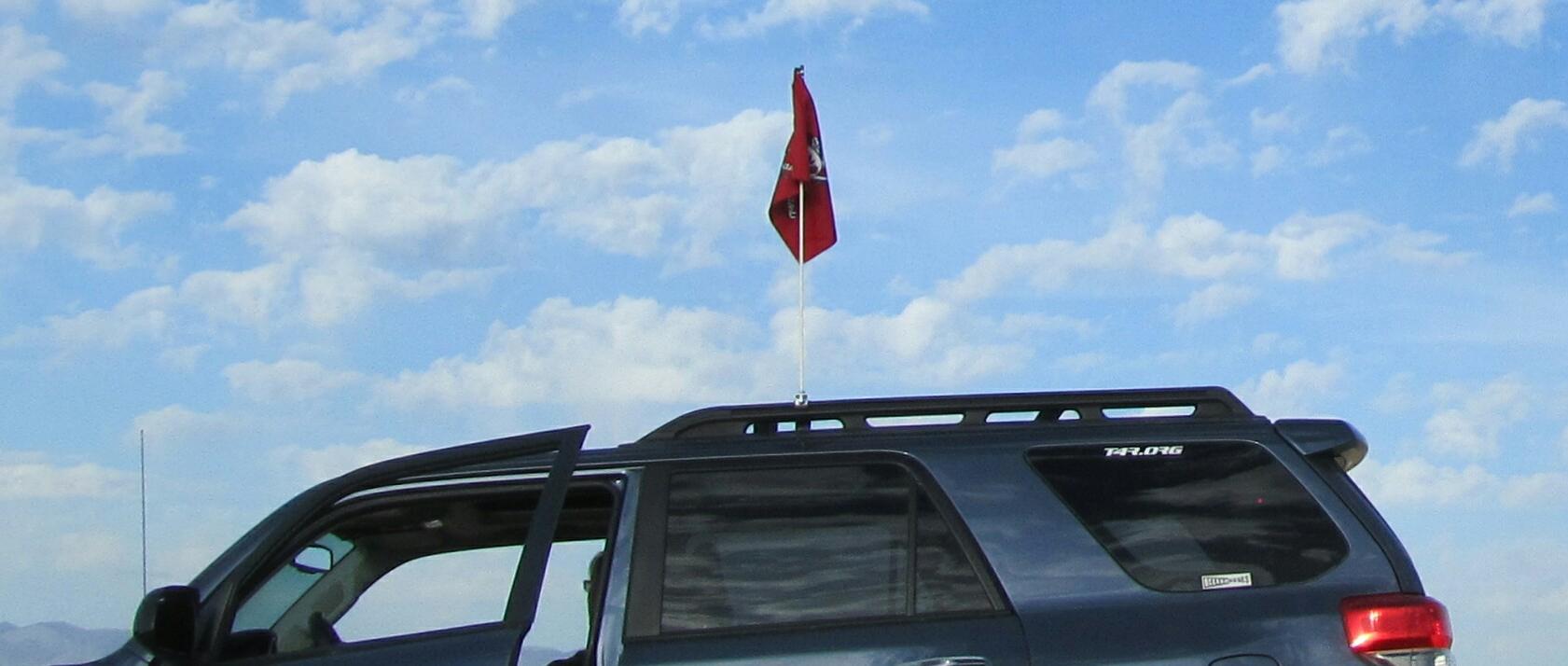

I use a clamp on the roof rail that I found at a Pilot Truck Stop store in the antenna area. I use a 4 ft pole and my flag is 10 ft off the ground. (That's a 3 ft pole in my photo.)
I see the op is from Michigan. The last time I was at the dunes in silver lake Michigan it was required that the flag mount on the front bumper. Not sure if it is still the same or not.
Yeah the rules in Silver Lake dune area are the same. Trucks/SUVs need their flags mounted on the front of the vehicle. :/
