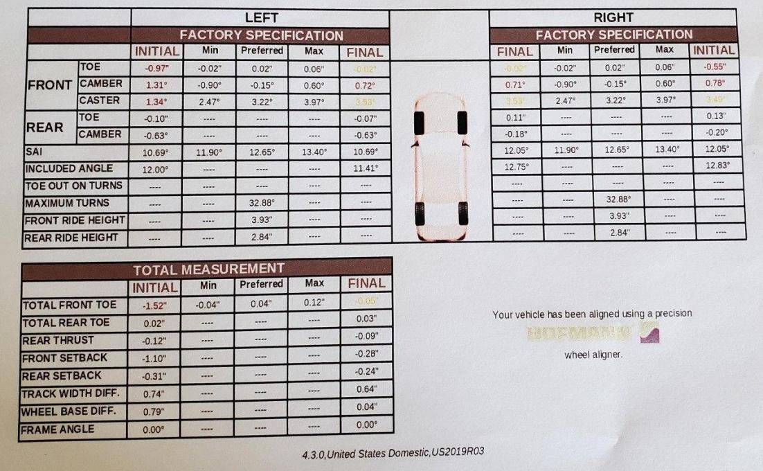

Hello guys! Recycling an old thread to get your opinions.
I have installed a new lift (F3" / R3") and of course did an alignment afterwards. Although I understand the very basics of it I dont have enough knowledge to asses whether the shop did a good job and I should come back to them or if I should keep looking for a place I can trust.
Please see the numbers below and let me know what you think!
PS running an icon uca
