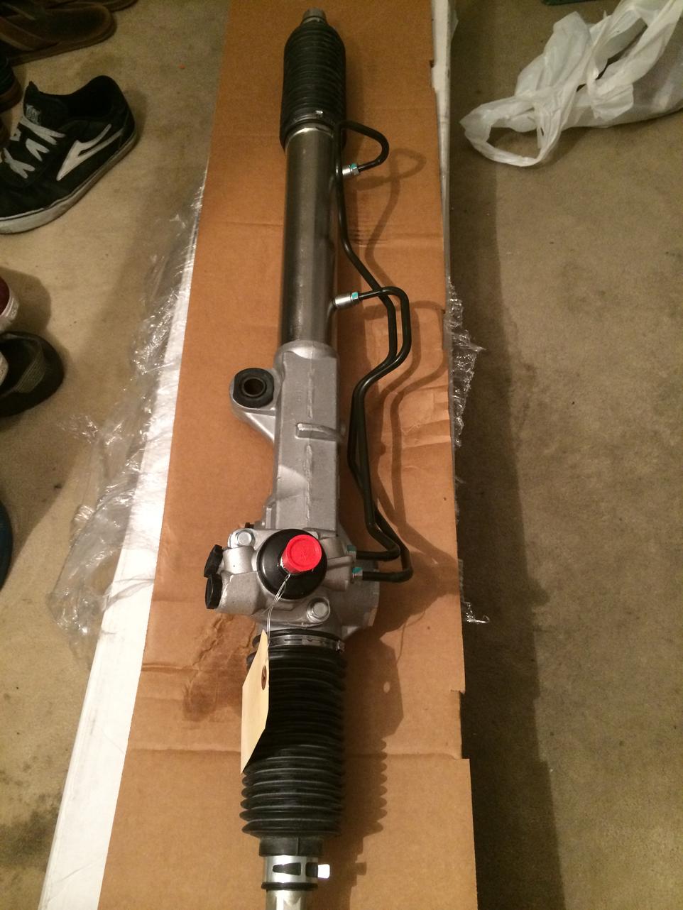

So I made the plunge and got the Safari rack. Colin over at Safari was a great help and was generous to give me a 10% discount which made it $475! :bounce:
Definitely can't wait to get this replaced this weekend!
Any words of advise before I do this?

yeah flush your system so you dont risk contaminants getting into the rack, make sure you have it at dead center before installing it (turn from side to side all the way, and count how many turns, then find the middle), use poly rack bushings, and get an alignment asap.
