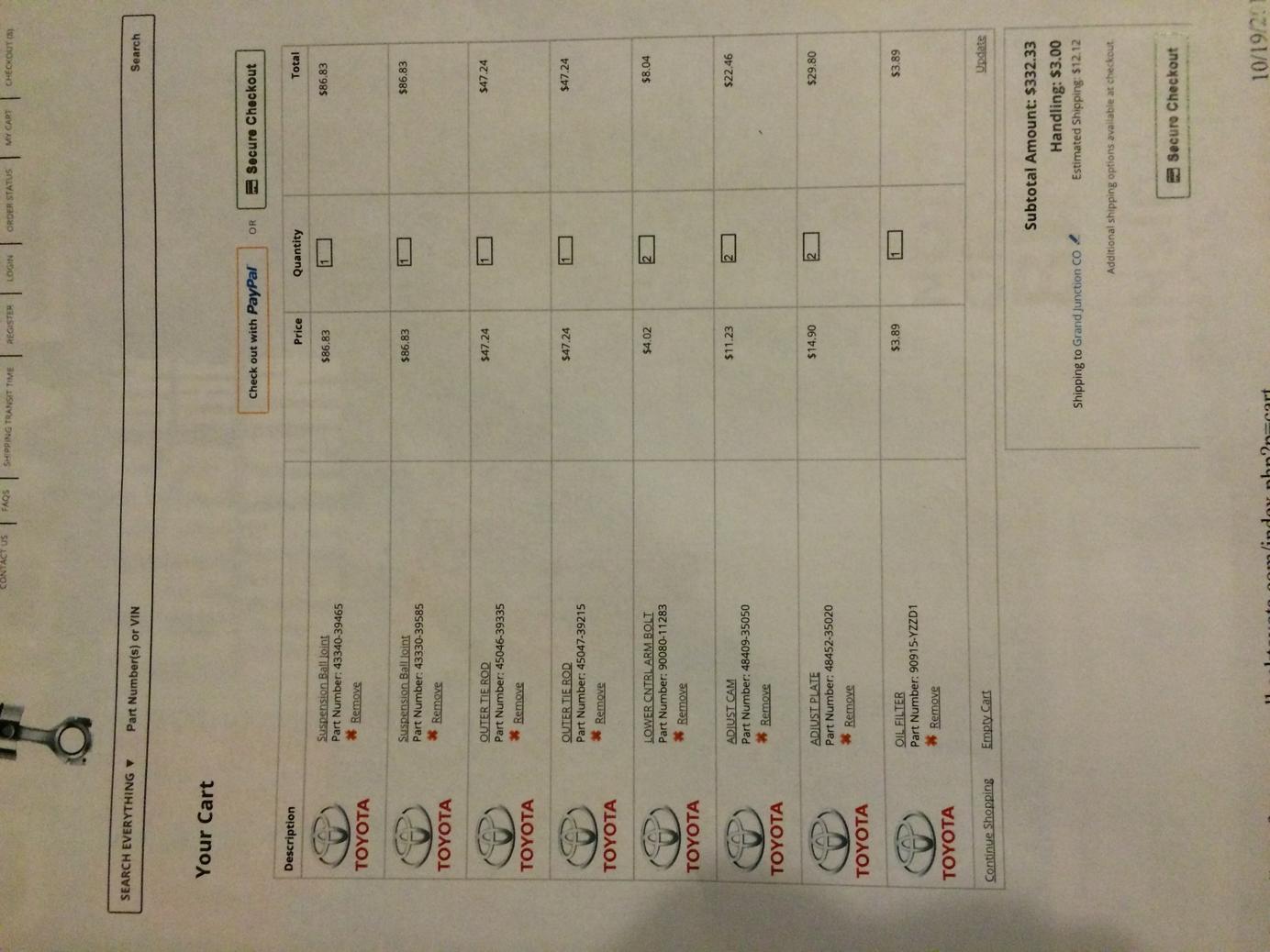

Decided to do OTRE's LBJ's new LCA bushings and all related hardware so I can get it all aligned. The bushings are not available that I can find through camel back so I'll order aftermarket elsewhere. Here is my shopping list, anything missing?
