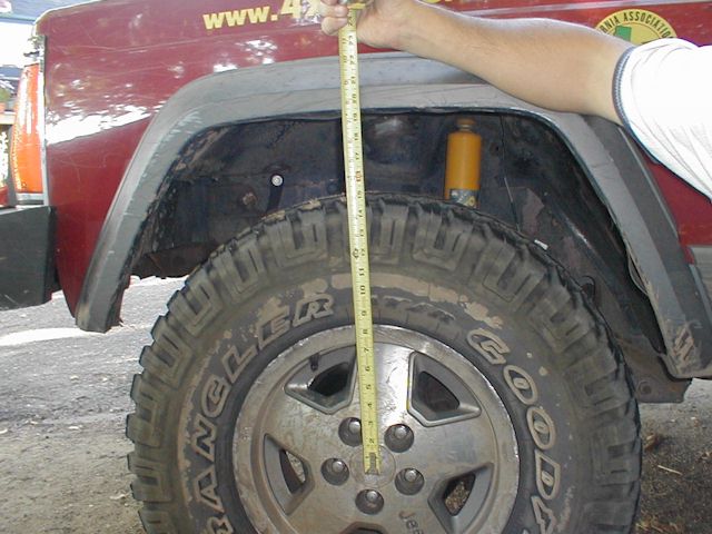

Your description of your measuring technique leaves a lot to the imagination but if you're doing something like comparing the height of the Toyota emblem to your belly button from year to year there are a lot of variables to account for there :D
If you want to start taking accurate measurements to reference in the future you should measure from the centre of the hub to the bottom of the fender (see photo. Sorry I could only find a photo of a Jeep). Measuring it this way removes every variable, including tire size or pressure, and provides a strict measurement of suspension height that you can compare to any other 5th generation 4Runner.
FWIW as a comparison, the front hub to fender measurement on my 2010 is 19.25" and has been since I bought the truck in 2014.
Thanks for the tip. I will start tracking it with this procedure.

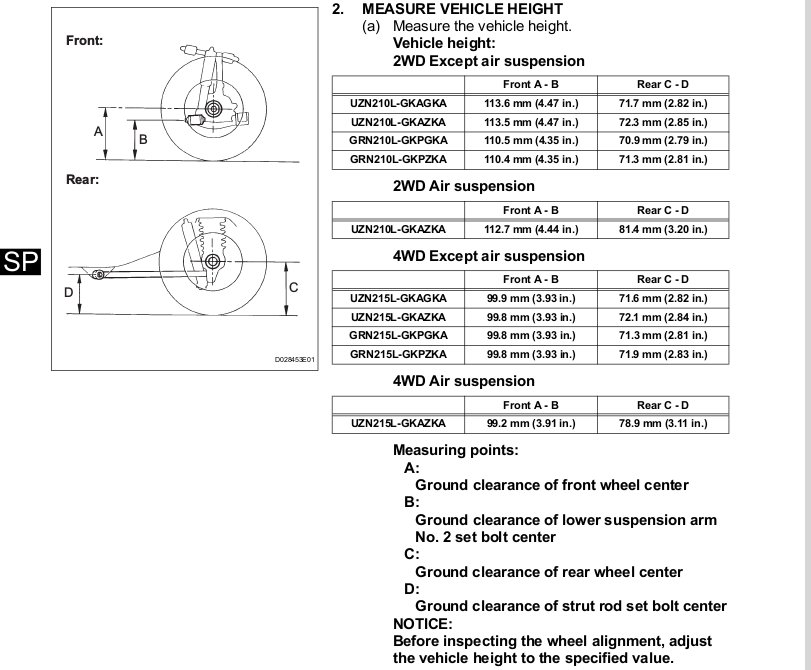

View attachment 216351Here's the official way to measure the suspension height on a 4th gen. Along with removing all effects of tire pressure and tire size, it allows you to compare your measurements to the official Toyota specs.
There should be a similar manual page in the FSM for the 5th gen.
