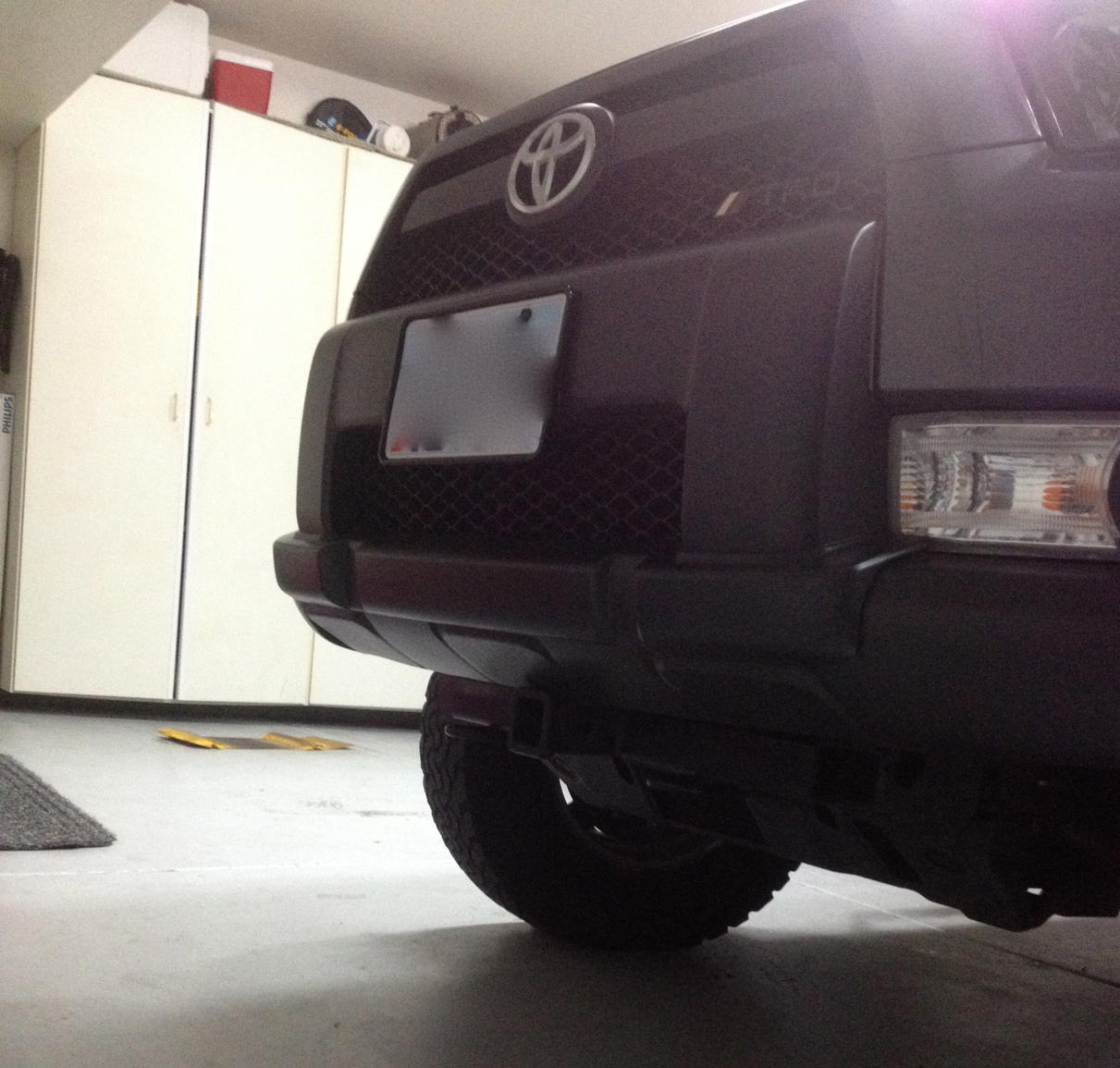

I was thinking of installing a front hitch on my Trail when it arrives. Does anyone have pictures of the the Curt 31367 hitch installed on their T4R Trail Edition? Is it discreet and does ground clearance suffer?

Unfortunately, that's a pic of a LE with a front hitch. Isn't the front fascia different on a Trail edition?
Yes, the front cover is different.
No, clearance would be no different than what is shown in the picture because it would mount in the same position. The actual bumper (what's behind the cover) is the same, as is the frame, etc. KDSS changes things a little.
You would have to be your own critic on whether it is "discreet" looking. Most people don't buy front hitches because of looks.

Here is the photo you asked for. There is plenty of clearance. Hitch sits higher than skid plate.

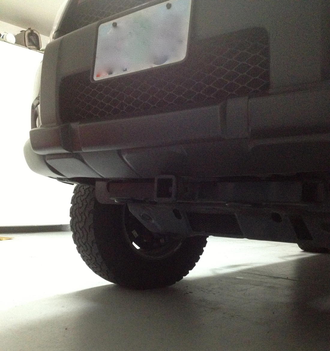

OK...got the Curt hitch installed today.

I was hoping that the plastic splash guard could be retained to keep road debris away from the rad, etc. Did anyone have success saving it or did you just toss it?
I too was unable to retain the use of the plastic splash guard. So I am placing it away, should i ever need to remove the Curt Hitch.
I see on the forum, that some members are being charged up to $200 for replacing that exact piece. So hold on to it. or offer it for sale to the forum.
Good luck and enjoy your ride... ps. take the curt sticker off...total detraction from admiring the the front end.... ;)
