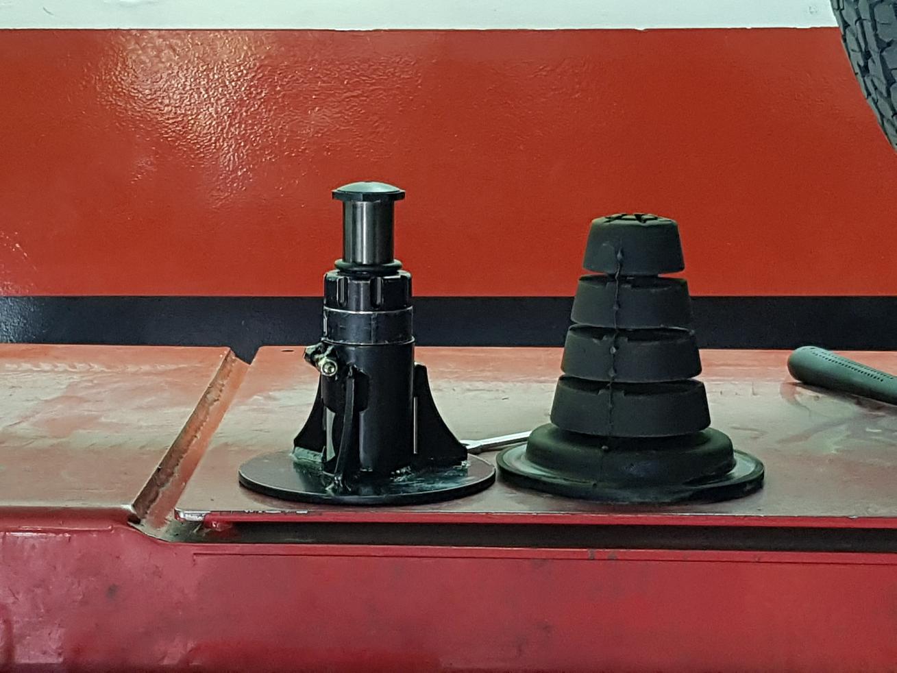

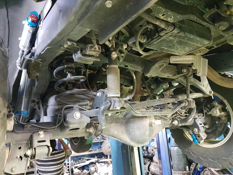

Here are my bump stops. I have the total chaos mounts in. But, I also ordered som Resz Fab rear links. So, I’m going to wait to have everything for the install.
