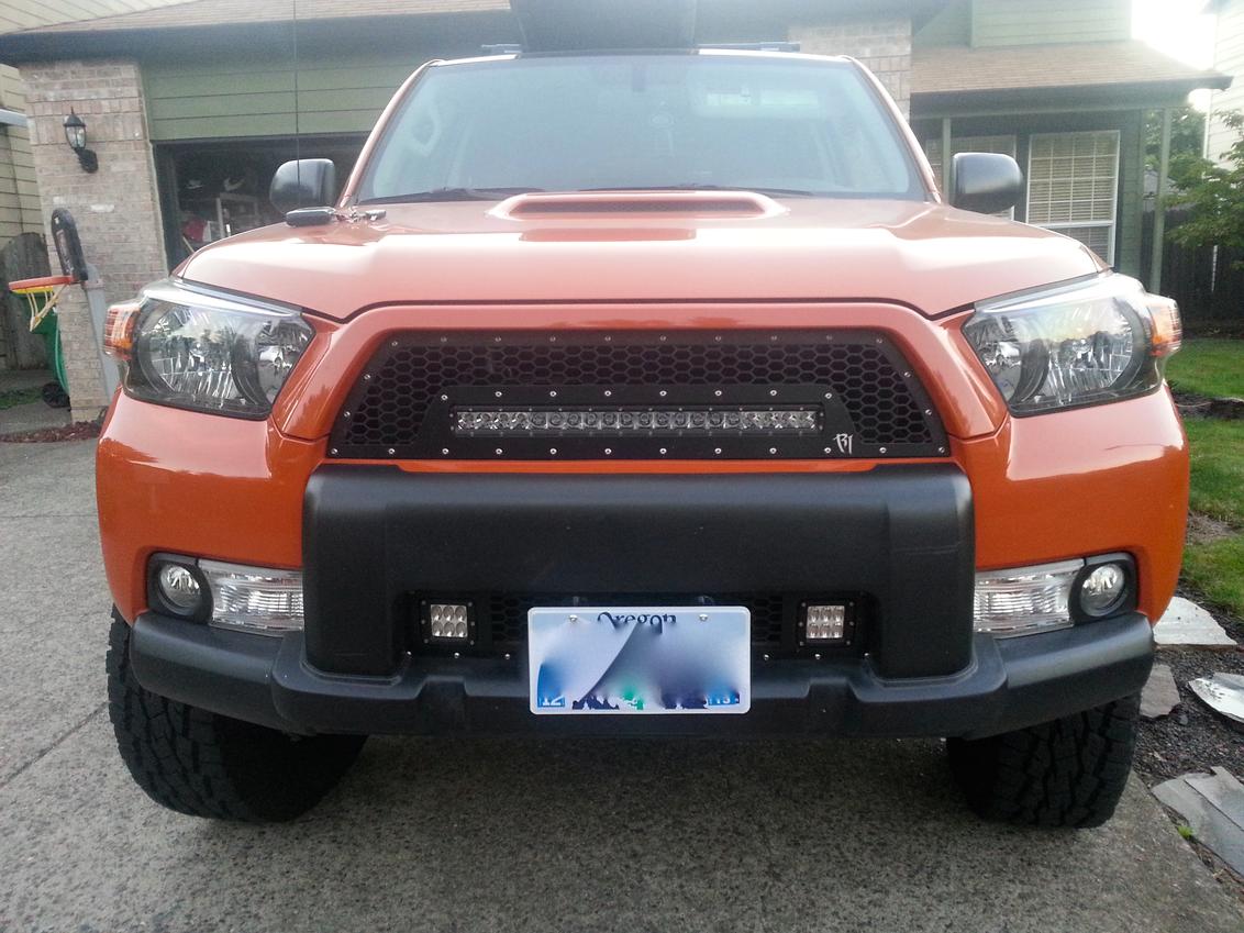

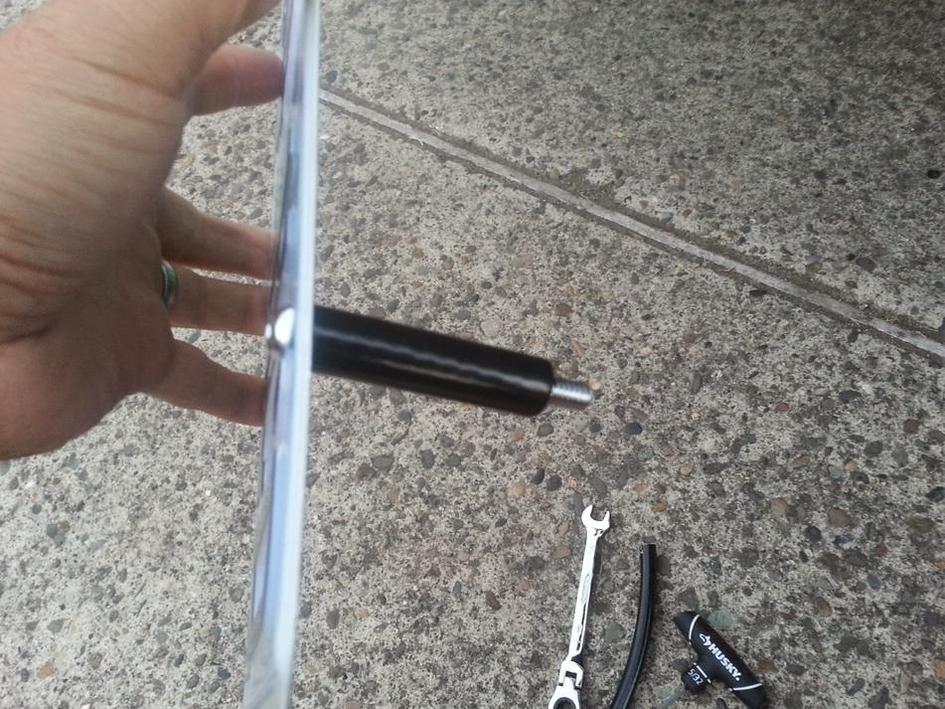

my solution
I used a 4" bolt, 1/2" rubber tubing as a spacer to place the plate in front of the lower grill. The lower part of the plate rests on the plastic faring with silicone dots as cushion against the plastic

Not trying to be an a$$hole at all, but how is that better than the stock location in the bumper? Edit: sorry, I assumed this was another thread showing various ways people mounted their plates, not one showing how they avoided drilling into the bumper. I'm obviously an idiot.
