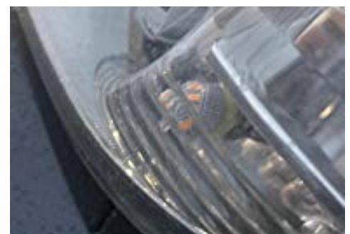

I thought I give LED a shot. The ones I got were a little longer than I like as it’s a little too close to the housing.
