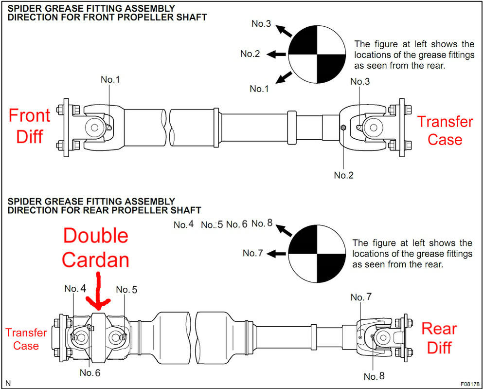

Here's the Zerk positioning for the 4Runner. The shaft needs to be in the right position. Take it back to the idiot who put it in wrong or ask for money back and get it fixed somewhere else on the premise that you don't trust them to torque the bolts correctly or something like that.

Thanks. That's what the Tacoma manual shows. Is that from a 4Runner shop manual? It's definitely not going back to the place that screwed it up.

Slip joint should be at the xfr case end but it might not really matter unless there is physical interference with the driveshaft. It's faster and easier to take it out and turn it around youself than it is to take it anywhere.
It really doesn't matter which direction it's installed. x2 on doing it yourself if you want to flip it. It's less aggravation than dealing with a shop that may or may not want to take care of it or not do it right (think of leaving bolts out or not torqueing correctly etc).
