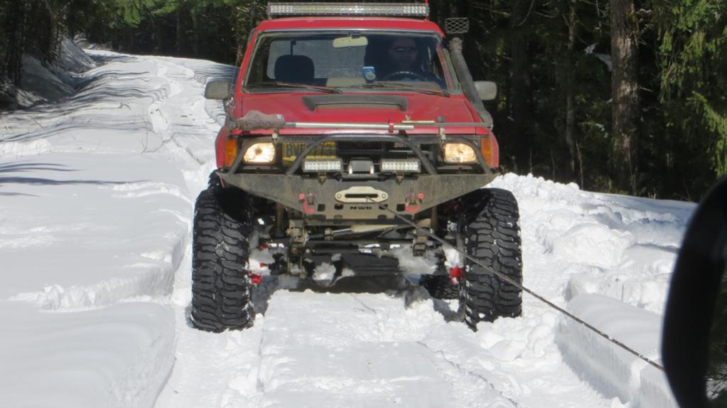

Last time I was helped by an '84 4Runner
You already have some welded on. Price is free. And they work pretty well. Paint them red and you can double the strength...
