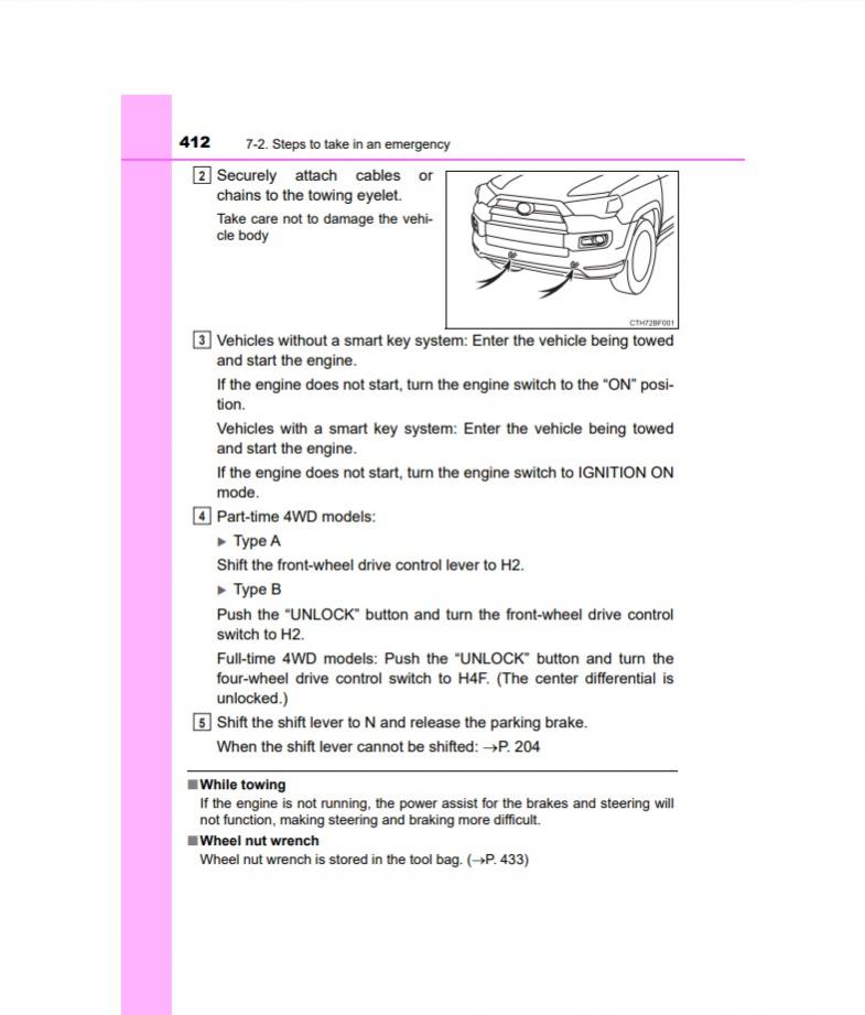

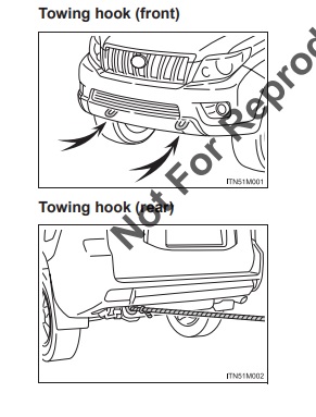

I'll just leave this here:
Hmm. Towing though. I'd say their definition of towing is probably a bit different than a kinetic recovery from thick mud, uphill, in the snow. With a vehicle that is 2,000 pounds over weight lol.
Either way, I like them. :cheers:
