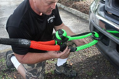

So far ive only used my soft shackle to connect a winch extension or strap. Definitely safer than a bow shackle in that application!

It is really a matter of knowing when to use a steel shackle or a soft shackle. Soft shackles need careful inspection for nicks, cuts, fraying or other damage. My concern is that one could become unfastened without sufficient tension.
I am guessing that ARB wants to limit pulls to a forward direction and feel a soft shackle might introduce or allow some angle of pull.
I agree with you and I personally carry 2 soft shackles and two traditional shackles.
