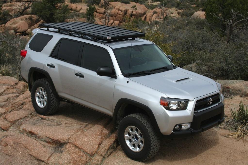

Im thinking of ordering this roof rack. I had a full length rack for my 100 series land cruiser and the quality is exceptional. The only concern is that it is 3/4 in length and they are not planning to make a full length one due to:
"At this time we do not offer a full length rack for the 4Runner. There are no mounting holes forward of the sunroof. In order to properly secure a full length rack you would need to drill into the roof of the vehicle. Extending the rack forward without properly securing will cause extra wind noise, chattering, decreased load capacity, and even damage to the rack or roof. "
Now this makes perfect sense to me, however how do the Baja, Gobi and Drabbit roof racks solve this problem?
Also what do you guys think of the look of this 3/4 length? Thanks
Front Runner Slimline II 3/4 Rack - Rail Mount / Toyota 4Runner 5Th Gen

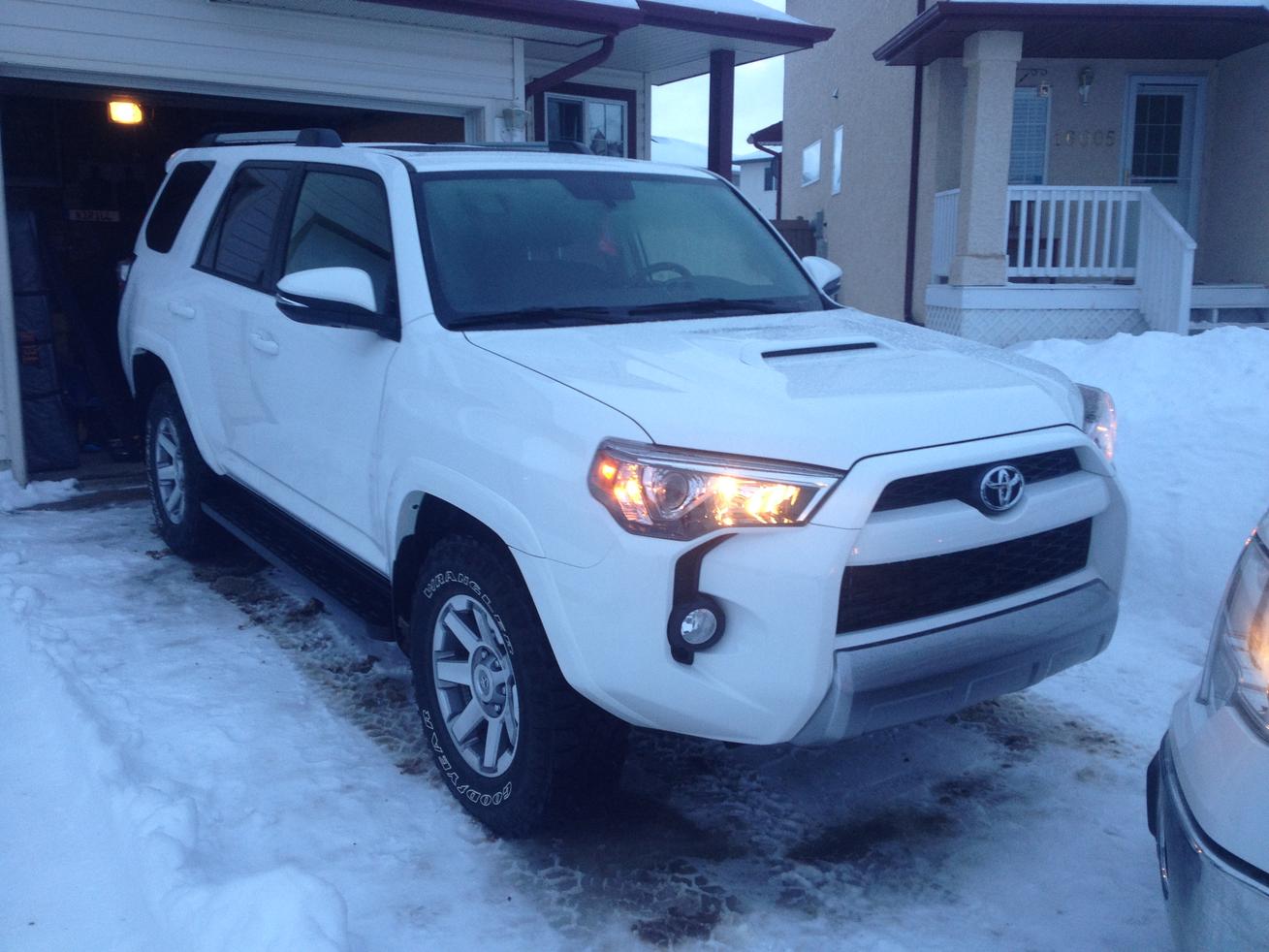

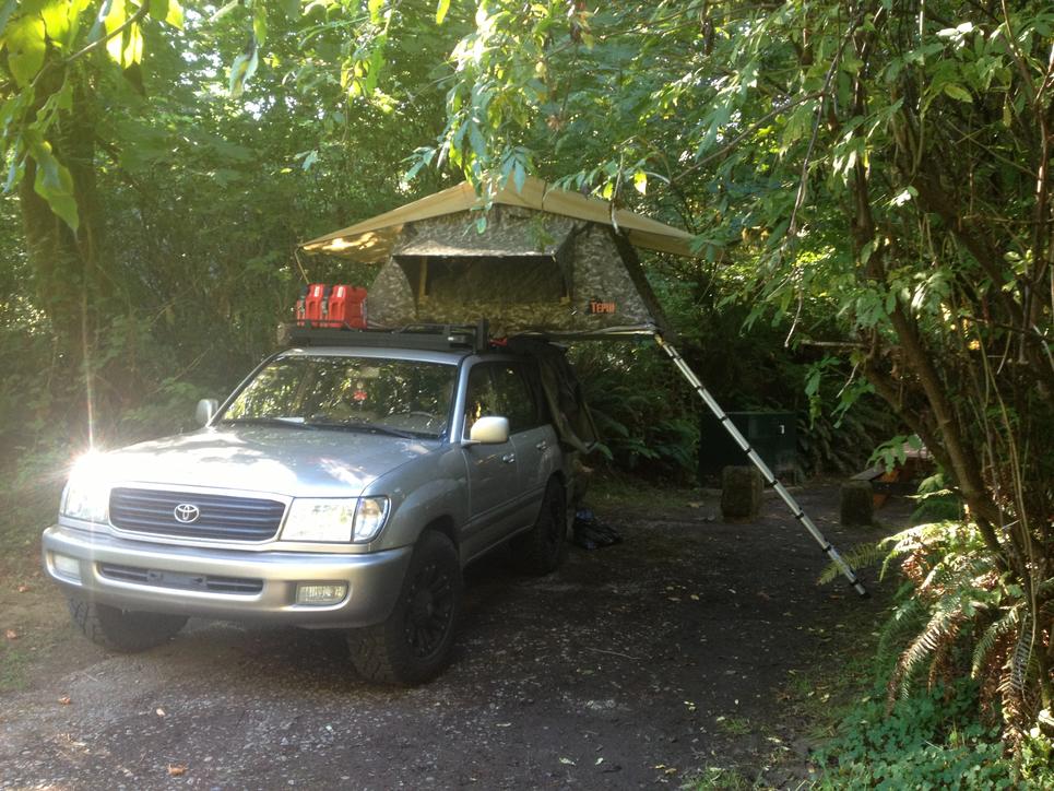

Btw this is the truck it will be mounted on with my Tepui Camo Tent & the whole setup on my old 100 series

That's not a bad looking rack. The Baja, and as far as I know the Gobi and Drabbit racks all make use of adjustable height forward feet with thick rubber pads to seat against the roof sheet metal. They use the 4 factory mounting positions with the forward feet simply being used to support the forward part of the rack. If I recall correctly Baja also makes a flat rack similar to the Slimline that is intended for RTT use. And their prices are competitive with the Slimline.

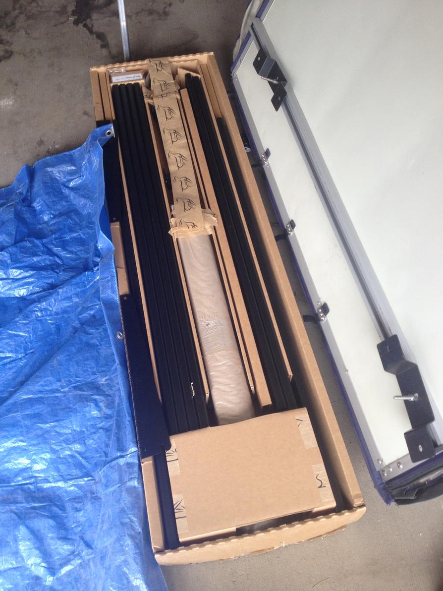

Yes, I have installed it. super easy, as always perfect craftsmanship and the bigger table fits no problems! Im very happy with it. Also installed my roof top tent on it! happy camping!!
One thing is that a bag of bolts was missing when the rack was shipped. To finish installation I went to local hardware store and picked them up for like $15 dollars but they started to rust, so I email frontrunner, got the response right away and they shipped the missing bag which arrived within a week (international shipping) FOR FREE! Im super happy with customer service and infrastructure. I have also purchased the bigger stainless steel table which folds nicely between the rack and the roof and a full set of cutlery for camping, again superb quality. I should mention this is my second rack from them, previous rig also had jerry cans and jerry cans holders, axe mount etc etc. All products have exceeded my expectations. Yes some things might cost more but you get what you pay for.

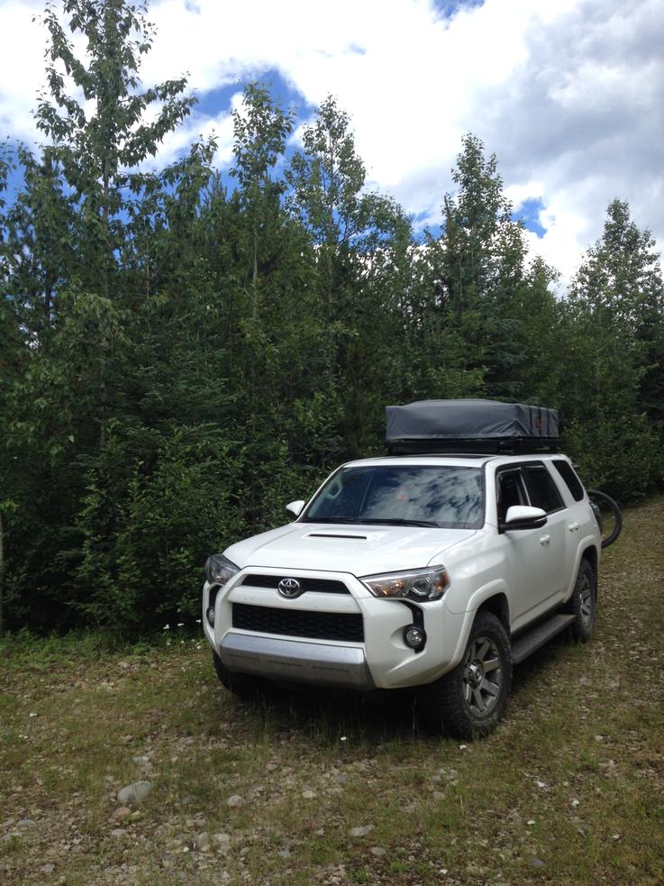

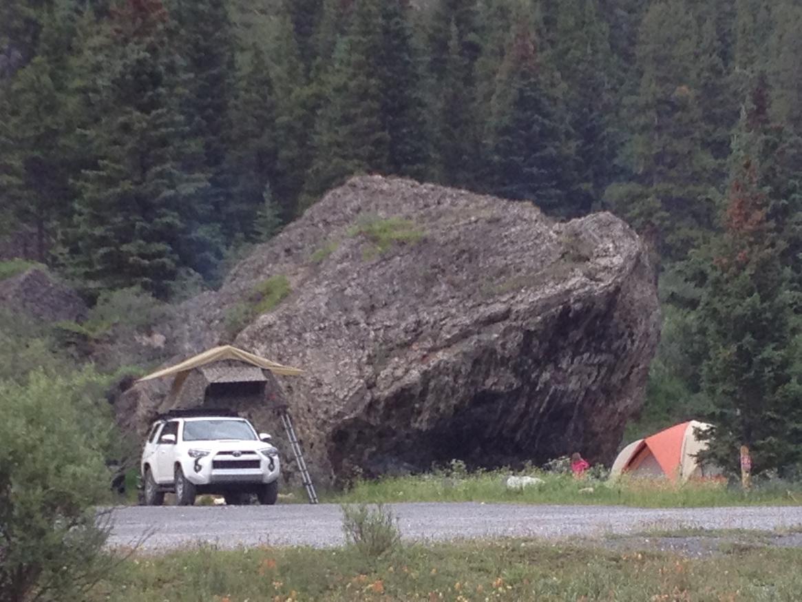

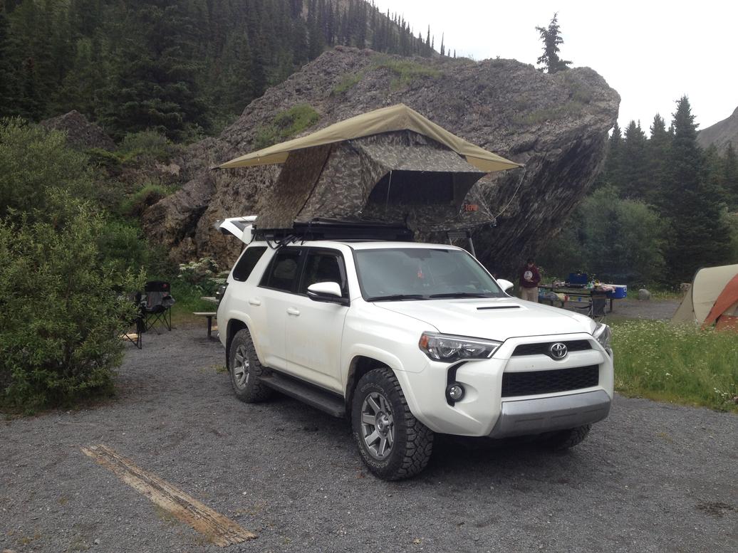

Has anyone who installed the rack experienced noise issue? Im not sure if it is because I have the tent up there or because there is tent and the stainless steel table hidden but my on speeds of 60mph + the whistling sound is there and I have to close my sunroof and slide the solid carpeted section also.
This means no sunroof for me in the summer on the highway, that being said I never open it anyways because of the bugs we have in Alberta which bounce off the roof top tent wall right into the interior lol
Anyways, anyone with noise issues and resolutions to this?
Some kind of deflector that I can mount?
In the meantime, here are few photos from camping last week (sorry for last blurry iphone photo lol):

No whistling here with just the Front Runner fairing. I pulled the Thule fairing off late last week to try the Front Runner fairing and its a lot quieter at any speed. I would think the Thule would be better but at 75mph it made a lot more noise than the Front Runner set up. Also as an added bonus it takes up a lot less real estate up top.
Have you tried it without the table? I am guessing that might be causing the whistle you are hearing. That or maybe stuff a strip of foam pipe insulation between the table and the rack and see if it goes away. Any way just some ideas hope this helps.
