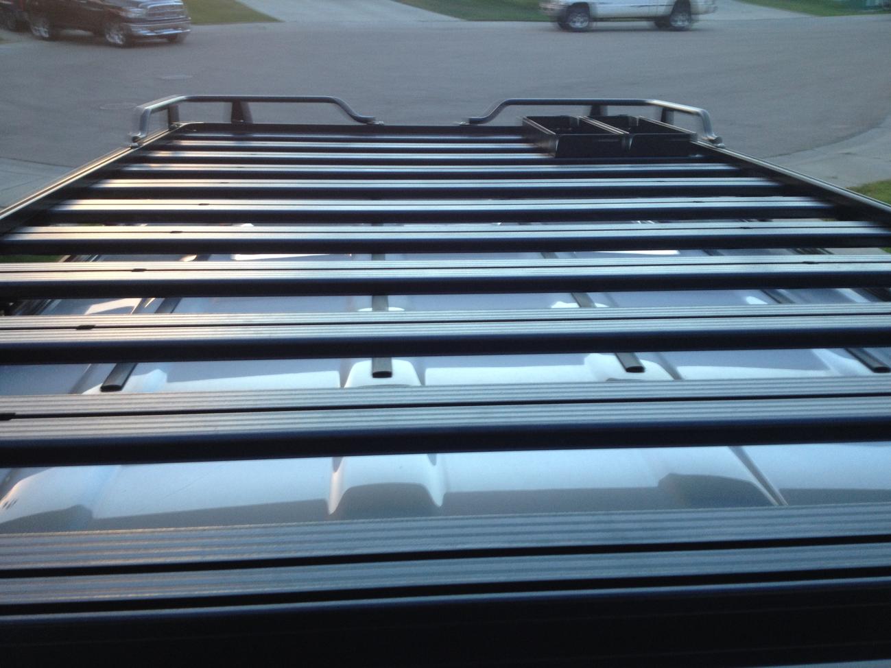

I have a question on assembly. I want to remove the shark fin and put a ham radio magnet antenna mount in the same spot. Can the rear-most slats be moved forward to allow the antenna to be placed there?

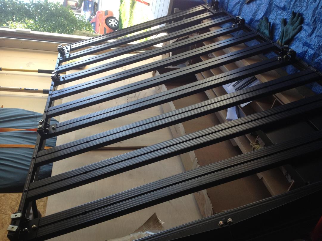

Are the slats easily adjustable after it's on the roof? Sorry for the questions, I've never seen one of these in person.
I would say not so much. Each end of the slat goes into guide slots on the two outer frames on the roof rack. Essentially all the slats get sandwiches by the two outer frames. Now if you wanted to slide the slats back and forth while the roof rack is on the roof, it could be done by unfastening the two allen key bolts (1 on each end of each slat), wrapping a hammer into some cloth and slightly bumping the desired slat back or forth until it gets to its new position where the allen key bolts can be re-installed. However, if you wanted to take slat(s) completely out, partial dis assembly of the roof rack would be required.
Note: The distance between the two slats is equal to the width of a slat. so you can either have equal sized gaps equal to the width of the actual slats or a solid roof without any gaps. The holes for the allen keys to secure the slats are spaced exactly in that way.
Hopefully this helps.
Here are the photos if the full length rack from my 100 series land cruiser, this is exact same design just longer. Hopefully this helps:

Thanks, Taco04. I have a magnet mount with I think a 6" base, so it'll definitely fit underneath the slats. Just wondering if it will contact the slats with the wind or movement. I did find a thread about removing the shark fin, so that helps as well.
