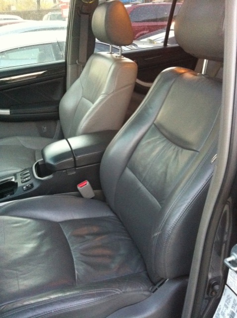

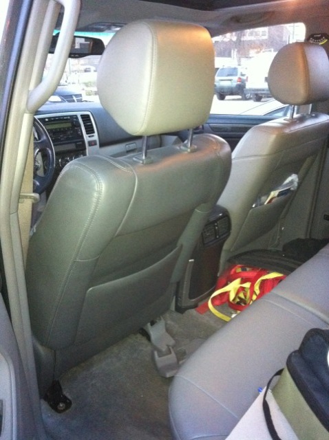

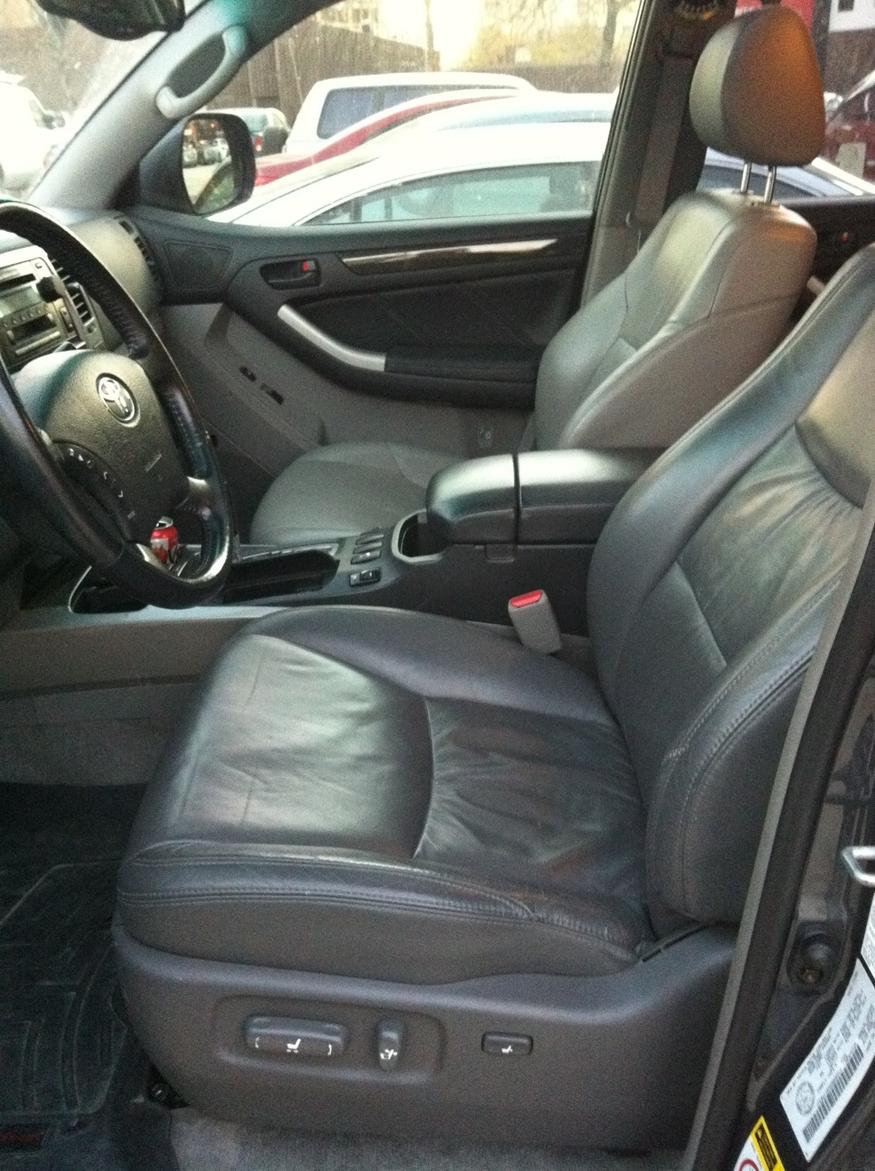

it's in!
Ok the seat is in!
I had a local shop execute my plan...replace wiring harness, and switch assembly. I do not think this would be required if you had a 4runner with memory seats...but I'm just guessing.
PRO
1)it just feels right! excellent seating position. Feels more like a dining room chair.
2)everything works, heat, seat positioning, seat belt warning.
3)NO SRS codes, but I'll never be sure if that side airbag will work or not.
4)it's minor impacts, so I could switch the seats back again. The minor part was cutting the the wires that run internal in the seat in order to avoid fully disassembling the seat.
CON
5)slight mismatch in colour, it's a darker gray.
6)armrest needed to be removed and shows a "hole" in the side of the seat.
7)at the lowest height setting, it's still higher than the oem. Maybe .5-1 inch, not sure, but that's a huge deal in an suv with already compromised headroom. I'm 6ft, and my hair touches the liner. I'm not sure if I will be able to deal with this...If you are shorter than 6ft this seat swap is a great thing. If not, or if your right on the edge, basically throw a 1" cushion under you and decide if you are still comfy.
To deal with 8 I might see if I can lower the rails to bring the seat down a bit. Again, we are only talking about 1/2 or 1 inch maybe. IF not, and if I am still not happy, then I'll just steal the lumbar motor and put it back into the oem.
It was interesting to try, and I'm almost at my budget for this, so hopefully I can get used to the height or lower it a little and keep under budget (budget being the cost of the part new + install).

Update - I had the seat lowered in Dec. I worked with a local shop. The owner/fabber looked at the options with me 1) lower the rails 2) sink the seat into the body. We took option 1 but not after pulling apart a good bit of the interior to determine feasibility of option 2. Let me say there is allot of "stuff" under where that seat sits! It just didn't seem worth it.
So he fabbed up option 1 and got us an extra 1 to 1.5" and also lowered the front. HE concluded that he would never do that job again, it was way to fussy/hard. This should have given me some extra headroom, but it's honestly hard to tell for sure. Maybe I grew.
So I have had some seat time, in the city and hwy. The seat itself is still excellent. But overall there is just "something" about the relationship to the suv that doesn't work. Can't be 100% certain. Just seems too close to the roof. Back to the seat, it is really good and it's "setup" does work, puts you up more like a dining room chair (which I like).
Overall, I do not recommend the GX seat swap.
