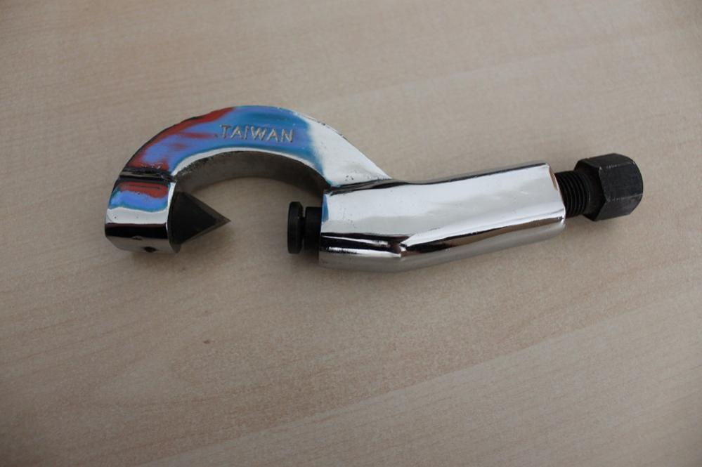

There are nut breakers too, to split the top nut, not sure the correct name...
