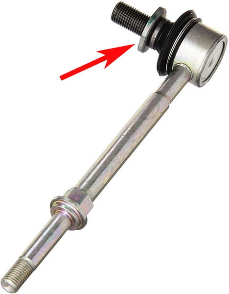

What's happening with the bottom nuts? Are they spinning in place?
There is a square flat nearest the ball end you may need to get a wrench onto.
Ah yes, I couldn't even see that and had to take the wheel off to get a good look at it. It looks like it may have had flats sides for a wrench at some point in its life, but they are indistinct now. Plus even my largest open end wrench (7/8") is too small to go around it. May have to cut it anyway

Finally got the nut cut almost all the way off and was able to back it off. I couldn't even get a vice grips on that flat flange in back until the nut was loose. And yep, it is indeed a square with rounded corners. Must be a 21 or 23 mm, because my 19 won't go on it and that's my biggest metric open end. Will definitely be buying one to get the other one off.

I bought a 23 mm wrench for that inner nut...it doesn't fit! I had to cut that one off too. That square nut thingie is a skooch bigger than 23 and there was really no room to grind it to size. Sure wasn't going to grind my new wrench lol
