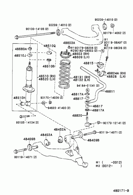

Breaking a stud doesn't make you replace the bar. The stud is part of the bracket (each bracket is held on by one nut on stud and one bolt) so you either need just a bolt or just the bracket, which is like a $10 part on-line. You can drill out the stud, but you will find it a PIA to tighten it but it can be done. Not worth it to save the $15 it will cost at the stealer, IMHO.
To my knowledge, there are no substitutes--but they only break when serviced, not in use.
Here is the right one on mine (verify if correct for your VIN):
48824-35120 - Genuine Toyota BRACKET, FRONT STABILIZER RH
Left one:
48829-35090 - Genuine Toyota BRACKET, FRONT STABILIZER LH
See part number 48824A on attached

I had this happen to me recently. I was replacing the sway bar to frame bushings, and the bolt rounded off. I just drilled it out and then went to ace hardware and got a similar grade 8 bolt and locknut to put down through the hole. Its holding up just fine and cost less than a dollar.
I'm sure it can be done and it will work just fine. I thought about it (I snapped the stud), but for $12 (dealer cost at the time), I decided to make it factory. No right or wrong, here.
