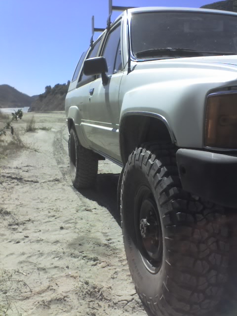

Its not that bad. It keeps all the crap off the side of ur truck + u can keep ur stock rims!

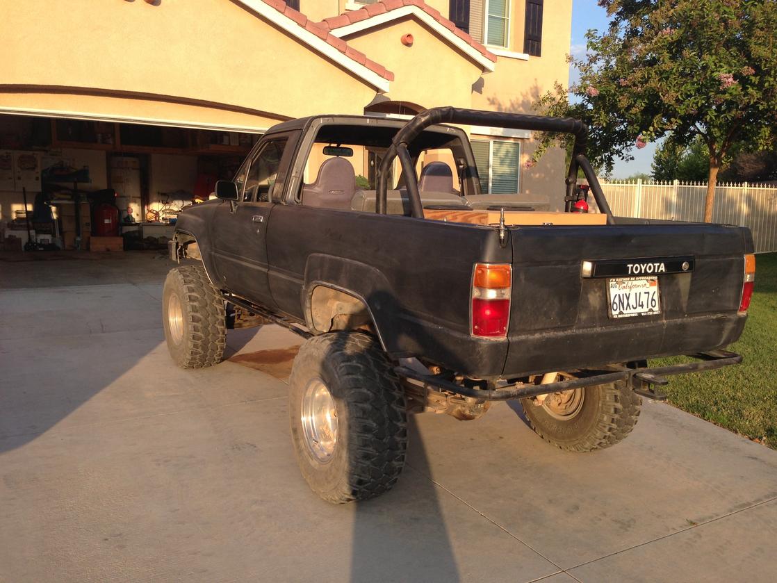

Mine are 33/12.50/15 on 15x10 wheels I like the feel of the wider stance
