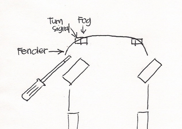

You can access the fog, and the front turn signal lamp assembly from the fender lines infront of the wheels.

i think you need to remove a screw and release a claw fitting.

Correct. Note: To remove the turn signal you only need to remove the screw closest to the bumper i.e. for the driver's side signal all that needs to be removed is the screw located farthest to the left. Then tug on the housing from the front of the vehicle while pushing from behind and it will pop out.

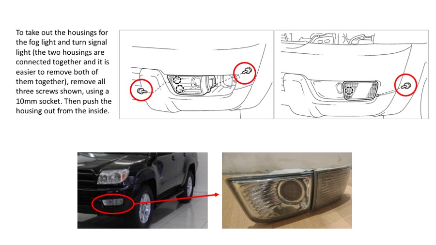

There is 1 Screw in the turn signal and 2 or 3 on the Fog. Remove them. Push fog light out and Turn signal housing will come out with it because they are connected to each other then you can seperate them. Easier than trying to push Fog out by itself
with pictures, since I had to do this today..

I’m trying to replace both, but one side seems be stuck while I had no issues getting the other one off. I removed all 3 screws as shown in the earlier pic and tried to push out from back and pull from front.

Oh. I had actually cut the original and when I put the new one on I realized you can tilt it (up/down with it facing you) and pull them apart, the fitting/tab keeping them together is like a hook.
How did you release the tabs?
Just had to remove the housing for a water filled turned signal. So hope you figured it out but if not there are 2 tabs on top of the housing frame that are black. Push those in and then using a flathead pry apart the grey housing that contains the lights from the black frame and it should pop forward right out.

I have not, I have an 05 sport and the only 2 tabs I see are on the side and are light grey. The previous link shows a thread that has pics on what to do, but I have tried to push in the tabs and they barely move. I’m tempted to just tear out the turn signal that I’m replacing so that there’s enough room to get the fog light out.

the link shows a good explanation. make sure youve removed the three screws (green arrows) and then the blue tabs should be able to be popped with a flathead while pushing the entire housing from under bumper and delivering it outside. The fog and the turn light housing are tethered together and should pop out as one unit. you can seperate them by twisting them apart. hope that helps good luck.
